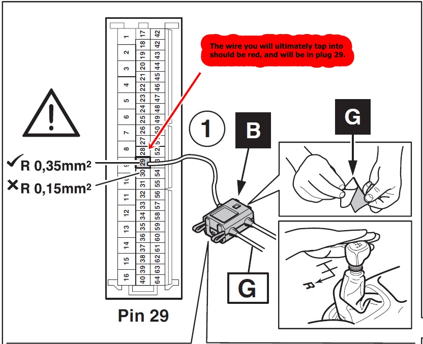

    Hi All!
    I installed this Ottonavi unit this weekend and am really pleased with the results. I love the way it can be customized so easily!
    However, the unit won't show ccd cam automatically when I put the car into reverse. I did tap onto this Pin 29 wire using the blue reverse wire from the HU. When pressing the ccd button onto the remote, it shows the cam, but that's the only thing that seems to make it work.
    Could it be because I got power for the cam from the rear license plate lights? I did it this way so that I could use the camera into all driving modes (D, N, R, etc.) when license plates' lights were ON. I did not run a positive wire from the cam to the pin 29.
    Thanks a lot in advance for your help!
    Pascal
  8. Monius
    Monius Junior Member
    Dec 2, 2012
    16
    Irishtown, NB, Canada
    I ended up running wire from cam to pin29 and also connect the whole thing to reverse light... Everything works fine now! I can't get cam running without putting car in reverse though... ah well!
