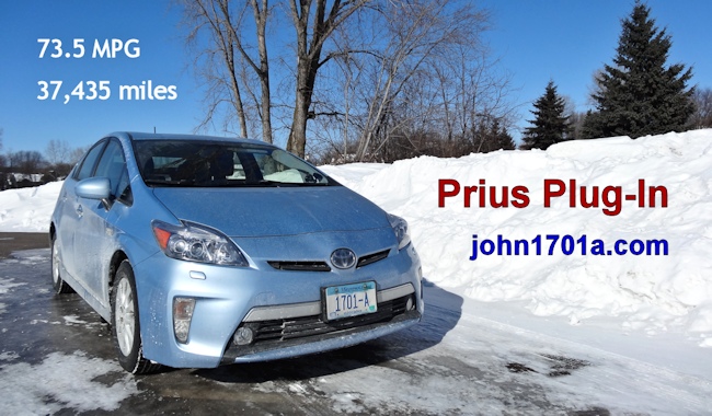

    Here's the front & back of a card I just created to share info about my experiences with the plug-in model...
    Sadly, I didn't catch the fact that kWh/100 miles was rounded. It's actually 27.7. Oh well, at least it gives me something to draw attention to.
    NOTE: the image has been corrected
  18. retired4999
    Aug 11, 2011
    2,652
    627
    Eau Claire, Wi.
    Nice job John! Looks great. :D
