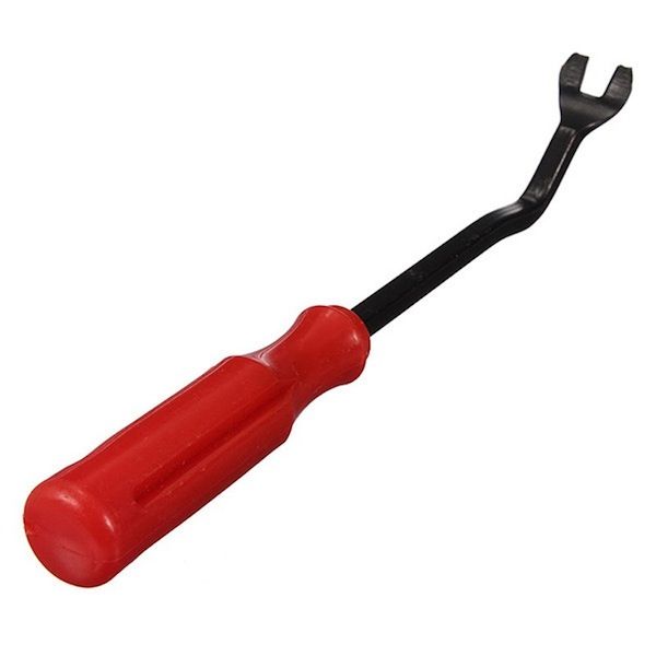

    Don’t even think about pulling anything apart in a Prius (or Camry) without one of these. Do a search for “trim removal tool” or “trim removal puller” and get one.
    Here in Australia we don’t have the range of gadgetry that is available in the US, so I buy this sort of thing from AliExpress.com
    eg: Auto Fastener Tools Plastic Fastener Car Door Panel Nail Puller Interior Trim Panels Clip Tools Interior Accessories-in Auto Fastener & Clip from Automobiles & Motorcycles on Aliexpress.com | Alibaba Group
    Store: https://www.aliexpress.com/store/2188017
    You’ll also probably find that various plastic clips will break (ie brittle from age). I buy them in bundles, eg: 30 x Fit For Lexus Toyota Corolla Scuff Plate Retainer Trim Clips 18x14x9mm Fastener 90467 10161-in Auto Fastener & Clip from Automobiles & Motorcycles on Aliexpress.com | Alibaba Group
    30 pcs Nylon Cowl Fastener Push Type Retainer Clips 90467 07117 ,1990 on (17 x 9 x 7mm)-in Auto Fastener & Clip from Automobiles & Motorcycles on Aliexpress.com | Alibaba Group
    Do a search on AliExpress for a Toyota part number and you’ll find cheap options. For people in the US there will be local sources.
