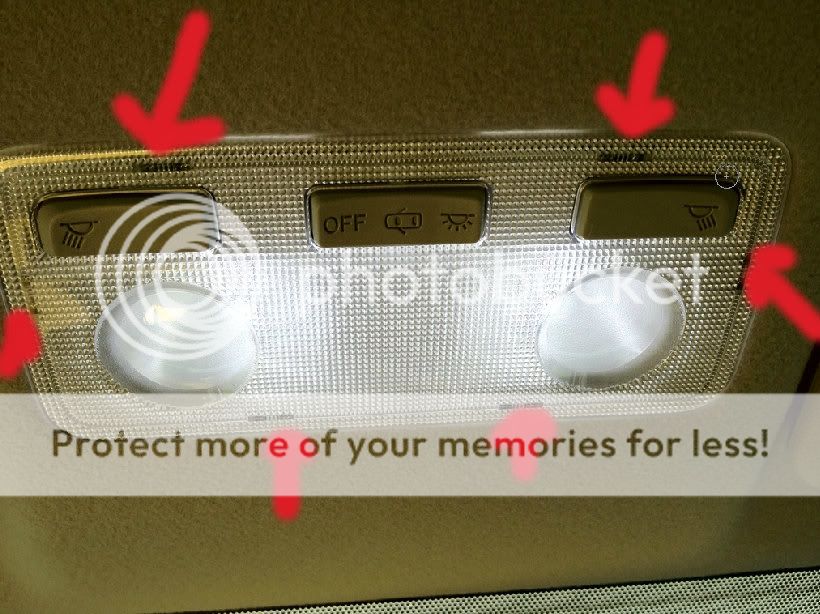

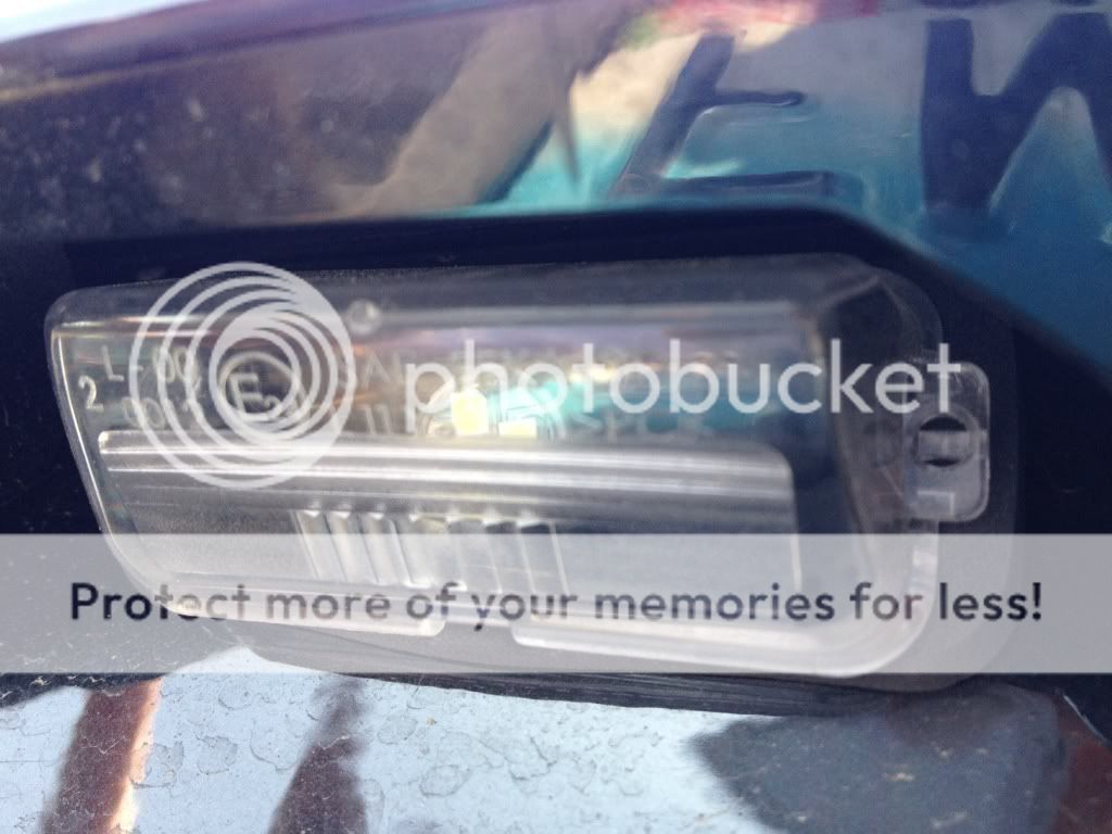

    do not know if these are the same he used, but I'm using them, they have slight bluish color to them when they're on. I use these in the dome, cargo, and license plate lights. Before plugging them in make sure the metal connectors are lined up properly, and bend them straight, or else the light won't light up properly.

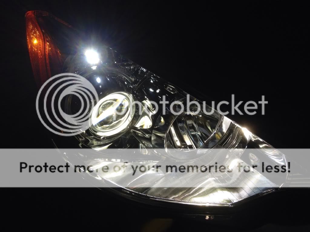

    I have been trying to upload pics but keep getting an error message. The LED DRL works well as a DRL but you will have no high beams. I live an an urban area and never use my high beams. If the pic would load I can get the hole headlight to illuminate by putting the high beams on it looks like one big white light.

    I have the headlights on and than just push the arm forward for high beams, since the LED is not a true highbeam it just lights up.

    Than just the LED DRLs light up see the second pic above that is DRL only on the headlight switch.

    What was the trick to getting the plastic cover off the light in the trunk? I fiddled around with it but couldn't get it.

    Just wedge a screwdriver in it and pop it off.
