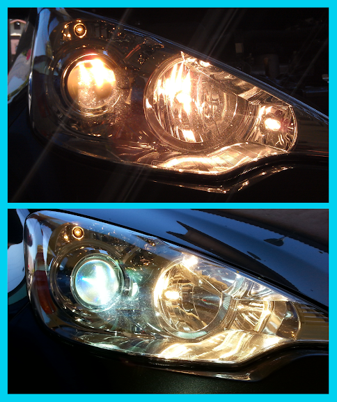

    I installed my XenonSupply HID kit this weekend.
    Here's what I ordered:
    Toyota Prius HID Xenon Headlight Package Deal
    Vehicle Year Model
    2009+ (H11)​
    HID Color Options
    4300K - OEM White (Brightest)​
    Accessories
    Accessory Relay Wiring Harness​
    Input Vehicle Year (i.e. 2011)
    2012​
    First impressions on opening the package:
    • Missing instruction manual -- but it's available online.
    • Missing 3M adhesive pads -- got some adhesive tape at HomeDepot.
    I started with connecting the accessory relay wiring harness.

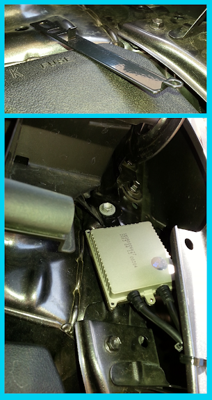

    This required tapping into the positive battery terminal in the fuse box. This was particularly difficult because of the need to remove the 10mm bolt in an extremely confined space. After quite a bit of fiddling around, I decided to abandon the idea that I was going to bring the accessory harness lead in from underneath. Instead I found that the inline fuse case fit perfectly snug within the fuse box. But I was going to need to do something mickey mouse to pass the wire out of the box.​
    Next I installed the new HID bulbs. This was pretty simple.
    Then I connected the ballasts and tested the lights. I did need to reverse the polarity on one of them. Then I bound the loose wiring with some zip ties and electrical tape.

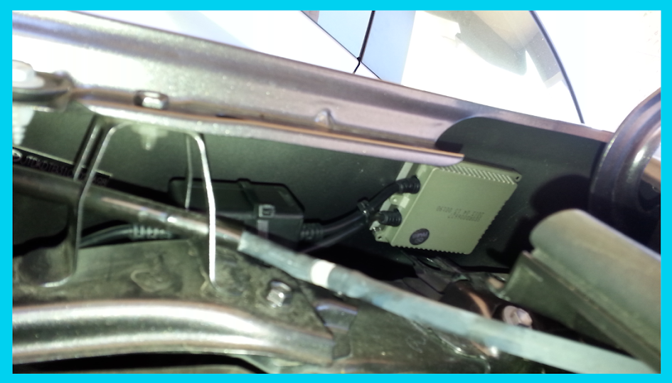

    Next I found a good place to mount the first ballast and route the wires. On the passenger side, I chose to affix the ballast with the double sided mounting tape to the interior of the body panel. (I'm concerned that the mounting tape will not hold up in the long term due to the extreme temperature changes it will be subjected to on the exterior body panel.)
    At this point I took notice of the ballast mounting brackets that were included with the kit. I decided to forgo the mounting tape and use the mounting bracket for the second ballast. I am much more comfortable with this mounting technique.
    And now for the Before & After:
    To answer the questions:
    Nothing illuminates when I put the switch in the DRL position.
    The above pictures are with high beams on.
    An unexpected side effect:
    With my HIDs on my FM radio reception range is reduced. It's not like electrical noise in the audio signal. The FM reception is crystal clear, but the signal strength is weakened. Not sure if it's relevant, but I'm also using the aftermarket shark fin radio antenna.
