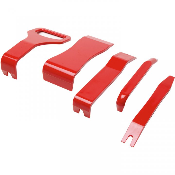

    I have always been nervous about prying on stuff with a screwdriver because the plastic panels are so easy to mar & scar.
    I saw a guy using these nylon tools in the rear camera install youtube video.
    It's just a few bucks for the set and you can freely pry on stuff without screwing anything up. Nearly everything in my gen 3 is held in with snaps and clips. These things are awesome.
    Search for "Wilmar W80648 Composite Trim Removal Tool Set" on Amazon.
