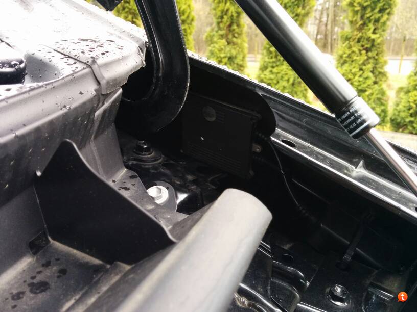

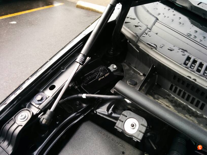

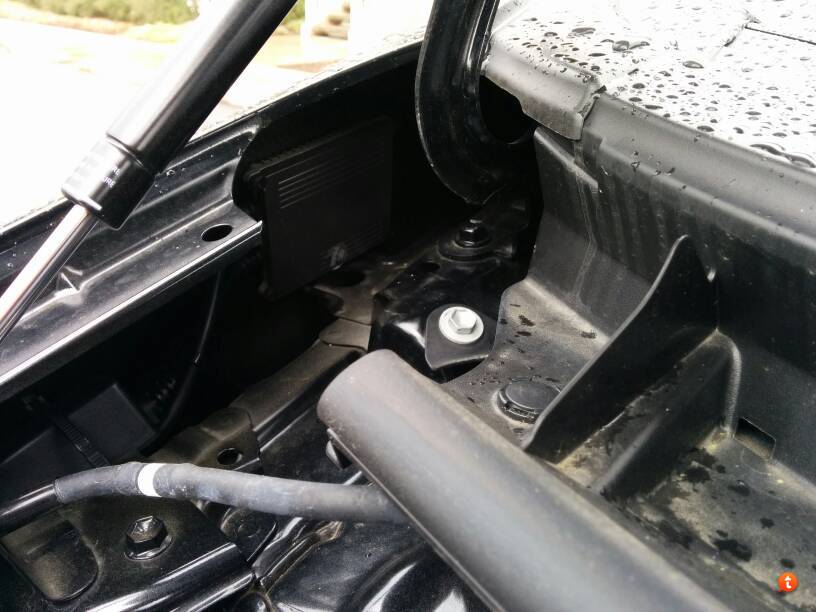

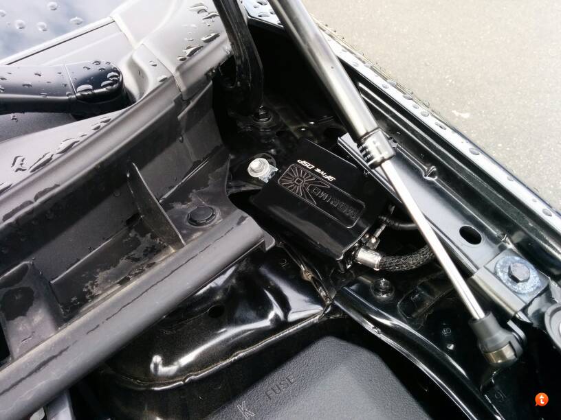

    I just changed my Xenon Supply kit with the Morimoto Elite with the H11 xb bulb. I actually like the color better as it matches my LEDs. The brackets on the ballasts are a plus. Here's before after pics.

    I had the same kit and loved it. The quality is unsurpassed.

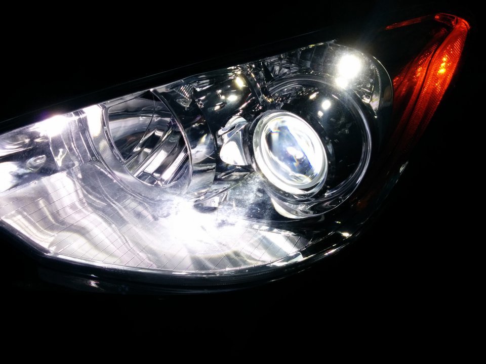

    Here's a pic of the 6000K Morimoto XB bulbs. Matches perfectly with my V-LEDs.
