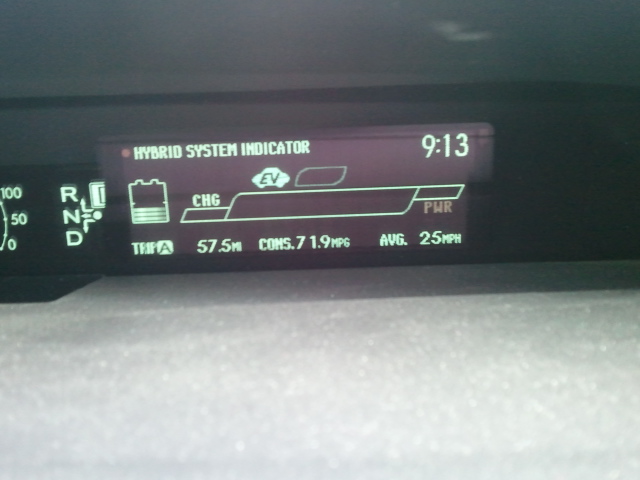

    Since you like to use up the "free" energy yourself, let me ask you a question, what's your MPG?

    My current mileage is just under 70mpg with 175 miles on my current tank. I had it up to 73mpg but have been plagued with a series of short trips. I do not use neutral or cruise control. Just pulse and glide. The picture was taken a couple of days ago.

    That's PIP territory :)

    I see that you are doing OK with your MPG. But look, my battery is fuller and will last longer.
