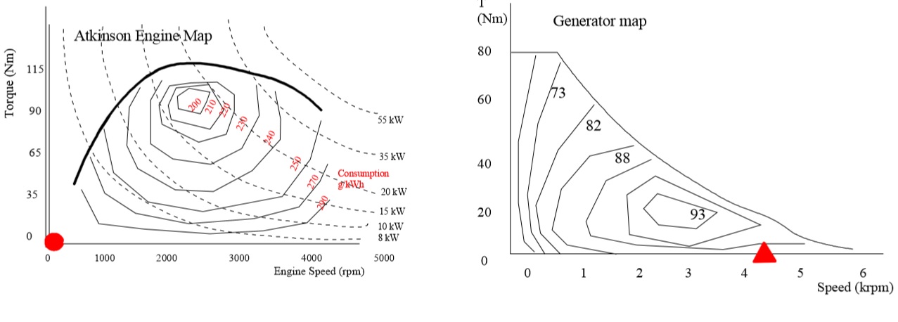

    Anyway: I don't use pulse-and-glide but still get good fuel economy (see signature). I'm too lazy to pay attention to anything but my books-on-tape. :) I think this explanation is best description of why Toyota programmed the Prius computer to turn-off the engine & use EV mode at certain points: What is an eCVT? How does it work? Here is the answer - Page 3 - General Powertrain Discussion - Ford Fusion Hybrid Forum
    "Suppose instead of operating at 2000 rpm and 90 Nm of torque, we operate at 2200 rpm and 90 Nm of torque. Then, from the chart, instead of producing 15 kW of power, we produce about 16.5 kW of power. The fuel consumption for 15 kW is 15 kW * 220 g/kWh = 3300 g/h of fuel. The fuel consumption for 16.5 kW is 16.5 kW * 200 g/kWh = 3300 g/h of fuel. Thus is it possible for the engine to produce more power using the same or less fuel by choosing a more efficient operating point. "
    "The question is what to do with this excess power achieved by moving to a more efficient operating point. We can't just apply it to the wheels. That would make the car go faster. Instead, we could doing any of the following: 1. Use the generator to charge the battery and place a greater load on the engine to absorb the excess power. 2. If the generator produces more power than the battery can handle, we could divert some of the power from the battery to the electric motor. Going in series from the engine through the generator, then to the electric motor, and finally to the wheels is a less efficient route than having the engine directly power the wheels. That wastes some of the excess power that we need to get rid of, but allows the car to operate using less fuel....."
    And that's why the Prius charges the battery and sometimes switches to pure EV mode.
    The Civic Hybrid does not have the ability to switch to EV mode when the battery is full. At that point the generator turns off, and the Civic acts like a pure gasoline car. Ditto the Insight, the Accord (2005-07), and the CR-Z. Overall Honda's design uses the battery Far less often than Toyota' design.

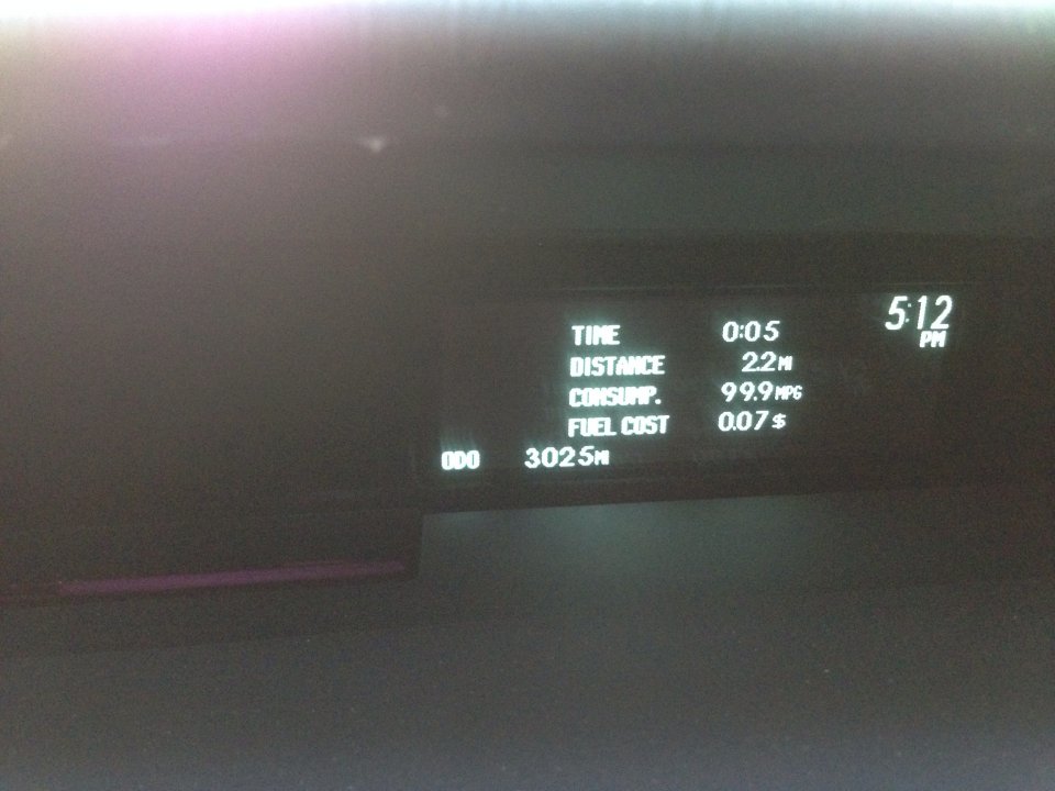

    I'm still waiting to make it I guess. My commute is almost 8 undulating miles. With only an initial startup ICE running I can make it home almost completely on the battery with no "red arrow" flowing. I regen down hills and at stops, glide a little to make it up and over the crests with less than a 10 mph difference. I rarely go over 45 mph and staying in as constant an "EV" mode as I can, consistently achieve between 75 and 99.9 mpg. On the display when I reach my destination. Pulse and Glide for me lasted about a week. Here's my first thing in the morning where is stop for coffee from being dead cold from the day before. I get this all the time. My first daily 2.2 miles.

    Those figures are from some other hybrid, not from any vintage of Prius engine.
    The GenIII 1.8L Prius BSFC commonly posted here shows it operating at nearly constantly efficiency (230 g/kWh or slightly better) from about 75-80 Nm at Idle RPM (roughly 8kW or 10 HP), all the way up to about 4000 RPM, 130-ish Nm (roughly 55 kW or 74 HP), along its programmed operating load line. There is no advantage to switching to EV mode when desired traction power is anywhere within this range. But it may pay to change engine power to charge up a low battery, or drain a bit off a full battery.
    At Idle RPM, below torque of about 75 Nm, the GenIII efficiency starts dropping rapidly. When the needed traction power is much less than this (~10 HP), then it likely pays to either run the ICE at a full 10 HP and put the excess power into charging the battery, or shut of the ICE and run EV. And because the battery capacity is fairly limited, this means the ICE will alternate on and off.
    In this low power and speed range, drivers can use Pulse & Glide to cut out the generator-battery-electric-motor portion of the energy path and its associated efficiency losses.
    GenII figures are different.
