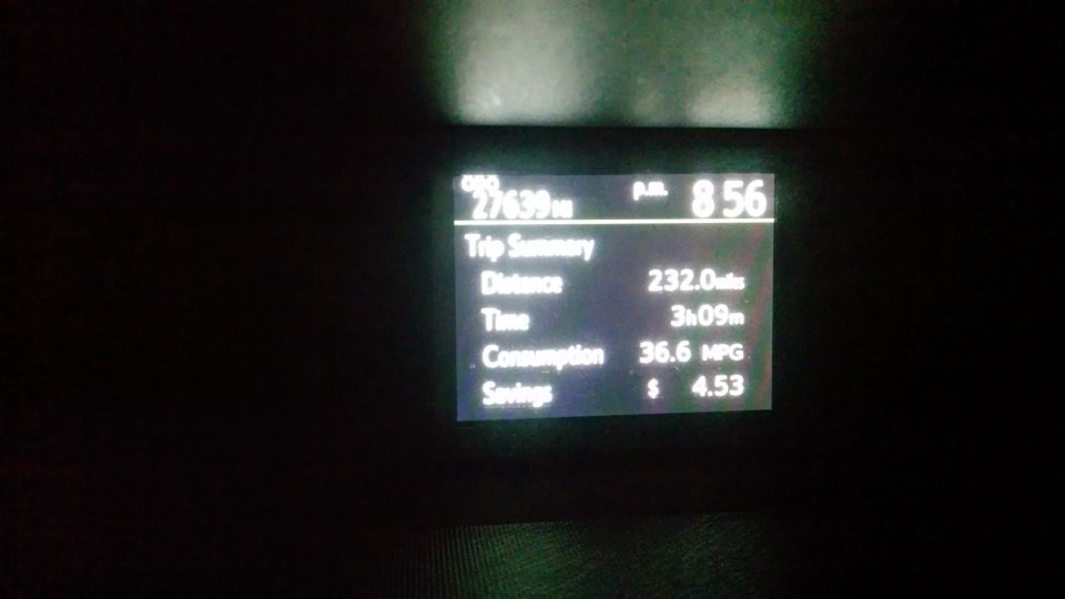

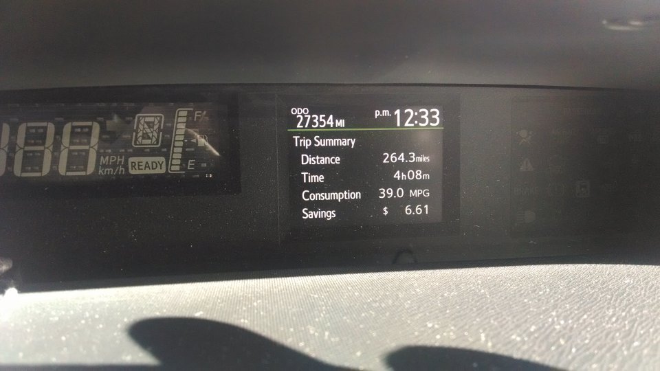

    No, no oil change at 5,000. I was dead set FOR a change, but after reading up some I wavered & then decided not to go out-of-pocket for it. Since the majority of my driving is city driving, I average probably around 20%-25% on EV for the route I take (slow speed limits, traffic, stoplights, etc.).
    I had the Prius C at the dealer so they checked all fluids & gave it a once-over for my 5,000 check up. As far as driving into the wind, it really wasn't that windy on the way down from CHI-->CIN; on the way back (CIN-->CHI), there was wind, about an hour or so of sleet/snowy mix also. But I don't recall it being heavily windy either direction.

    Thanks for this. I did try to do most of these; save the secondary, lower speed highways. Due to scheduling we had to leave in the late afternoon, it was already dark outside, and I really wanted to get there as quickly as possible. My son is 8, so trying to minimize time spent in the car and the need to stop for restroom breaks was paramount.
    But I will keep this stuff in mind for future trips; next time we travel on the expressways, we'll likely opt for my wife's '13 Corolla LE. I know full well what to expect MPG-wise, and we won't be nearly as cramped for cargo space as we were with my Prius C.

    I don't have a C but I would call that crappy mpg. It's not crappy enough to say there is a serious problem but something just isn't right. I have a PiP but removing electricity, I get around 58 mpg on my regular hypermiling commute below speed limit with semi trucks in the slow lanes. When I went on 2 separate 1000 mile roundtrip travels to San Diego, I averaged about 47 mpg. It's the same 8% drop on mileage. But my car was loaded with 5 people and more luggage. I was also speeding 80+ with the other southern Californians so I was shocked at the mere 8% drop in fuel economy. I was also blasting the AC which I normally don't do on my commute.

    Hasn't been that long since I drove a bunch around Cinci and I too got low 40's mpg. MPG depends a lot on how you drive and around Cinci there was much stop and go, lots of lane stagger, and lots of traffic manuvering, all of which are a lot worse conditions than the standard EPA mpg trials, which are merely for comparison. And its also possible you filled up with winter gas which generally has less combustion energy than summer gas, often because of ethanol, so low 40's is pretty normal especiaslly for the load carried. Next time try increasing tire pressure to 40 psig; that will help some.

    Not sure about the winter gas, if it was around in early November; in any event, the bulk of my poor mileage was on the expressways. I only drove around a little in Cinci, where my sibling lives it is a little hilly…but the damage was already done on the expressways of Illinois & Indiana.
