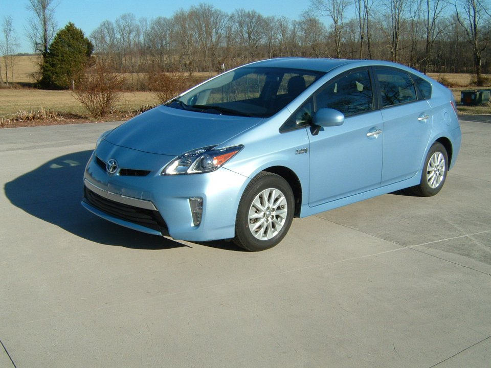

    Last time I looked, they are all gone, but there were in the past. I don't understand the quest for pictures, it is a totally stock light blue, nice shinny PIP, but I'll try to take, and post, a few tomorrow during daylight. I'm rather sure my project strengthened Steve's aversion to GEN 3 as it was far from profitable! But I'm sure a happy customer!

    DSCF0020.JPG Proving I'm no photographer!
