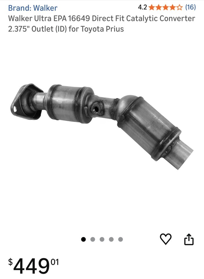

    I would replace the engine and install an aftermarket cat. I would not do the cat first hoping that would fix the misfires.
    Or junk it.
    This brand has kept the light off and claims to be epa compliant
