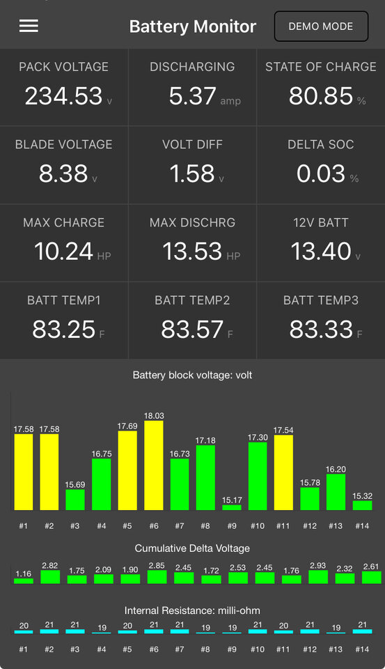

    Maybe assess the battery with something like Dr Prius, phone app that works with bluetooth OBD dongle. Carista dongle works well. Just the static test will give some idea; here's a screenshot, in demo mode:

    It seemed to me that the motor was revving up faster when I left from a stop yesterday. The bars slowly when up on a 12 mile round trip last night and ended up 60% on the battery icon. But this A. M., I was surprised to see that it is still 60%. My Prius is a 2010 model with 225,000 miles and with the original traction battery. Two years ago I power cycled the modules with a Bguad charger which cycled 4 at a time. My recollection is that all was at least 50% capacity of new. I think it is time for a newer set of batteries. Most ebay batteries boast X number of volts-a poor specification to count on. I saw one with 80 to 90% capacity. If true, that is what I should buy. I should replace all of the modules, I think.
    Looking at the Dr Prius reading shown above in post #3, which modules should be replaced? Or which spec is most important, voltage, delta voltage or internal resistance?

    IMO, the two most important specs on the Dr Prius app are VOLTAGE DIFF and DELTA SOC. VOLTAGE DIFF should be less than 0.30 volts. For a balanced battery, DELTA SOC should be 0.00%.
    Just drive the car until the P0A80 code occurs, then replace the hybrid battery.

    I never used the Dr Prius app. Perhaps if I bought the wireless plug-in device and the app, I could learn that replacing all modules is not needed and which ones to replace. (I have a laptop and a USB to under-dash connector cable) If I view the Dr Prius results of my modules, there are 3 different parameters; voltage, cumulative delta voltage and internal resistance. I assume that if any of the 3 parameters are drastically worse than most of the other modules, I should replace the weakest ones.
