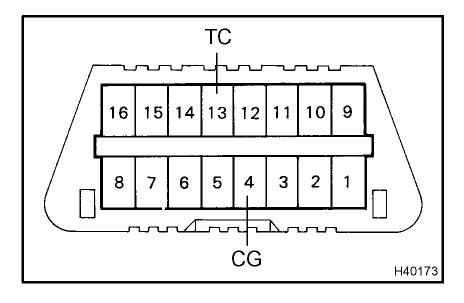

    Ok snooped around some more regarding the DLC/OBD pins 4 (Ground) and pin 13 (Assumed power). The diagrams are crowded and hard to read. It did look like pin 13 was power, and I was wrong about that
    Actually pin 13 is TC, which is used for the SRS diagnostic. There is a special service tool #09843-18040 that you use to activate the SRS diagnostic.
    Note: I would never, ever recommend just using a wire. If you happen to touch the wrong pins, you still risk catastrophic damage
    According to the service manual, this is the "quick" procedure to check for stored DTC's related to the SRS. The prefered method is still to use the dedicated tester
    [Pin 13 has nothing whatsoever to do with the braking system.] CORRECTED
    TC allows retrieval of basic ABS codes. It cannot command the boost pump, switch the solenoid valves, etc. The correct handheld tester is required to bleed the brakes

    Pin 13, on the DLC/OBD connector, is called "TC" and is referenced to in the SRS section of the repair manual. This covers the airbags, airbag sensors, etc

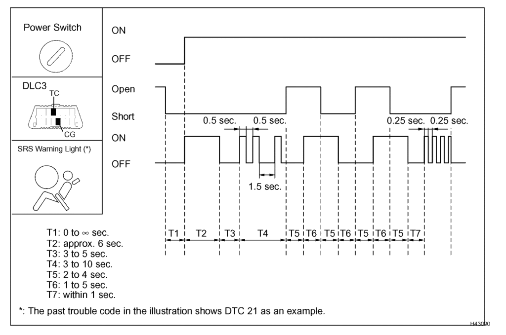

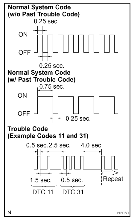

    The service manual *strongly* cautions about using the "blink" method. For example, a SST is required which is "goof proof." Just using a wire, they warn that shorting the wrong pins can cause "malfunction and damage." I bet!
    This is a sample "blink code" for an airbag system error on a 2004 Prius

    In the service manual this is the way to clear a stored airbag system DTC. The manual strongly cautions you to use the approved diagnostic tester

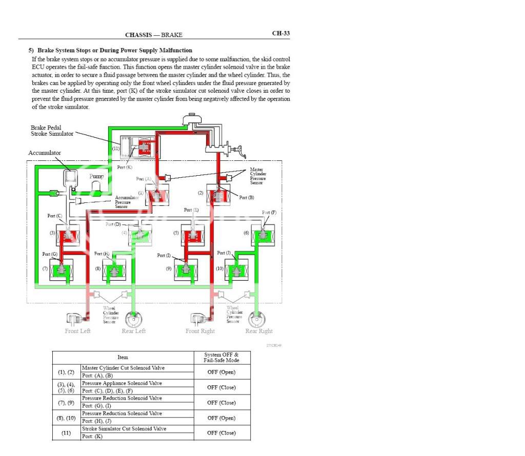

    I have already covered the correct bleeding procedure in other posts
    http://priuschat.com/forums/attachm...n-bleeding-prius-brake-bleeding-procedure.pdf
    As you cannot command the solenoid valves to switch with a simple DLC/OBD port shorting procedure, you risk having no brakes at all, or at least not the proper bleed procedure on the part replaced. The solenoid valve will close and isolate that system
    This is the Prius braking system

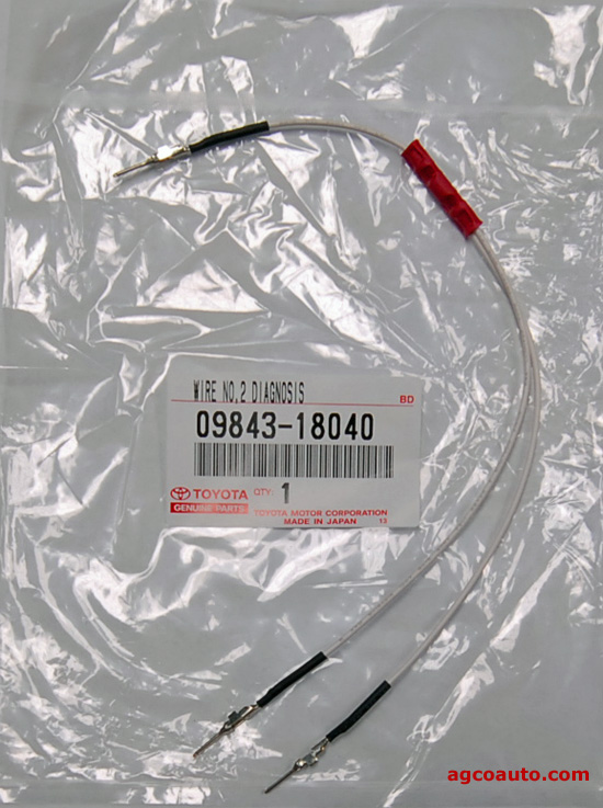

    It's 2017 and I just learned about these posts from someone who was scared off by them from following a simple, documented procedure to get ABS/VSC/TRAC codes when a scantool isn't available.
    As for needing to use the special service tool #09843-18040 instead of a wire ... it is a wire:
    Yes, if you mess up your counting to find pins 4 and 13, you might cause an effect you don't intend (and it might involve lasting damage to something, but more likely will cause some comm error codes to be logged and more lights to come on, and be embarrassing).
    If you get behind the wheel and drive into a tree or a pedestrian, you might cause a fatality. You trust yourself not to do that, every time you drive a car. To pull your diagnostic codes, you need to trust yourself to count to 4 and 13 (or match up the picture, or, even better, both).
    It's just not that hard.
