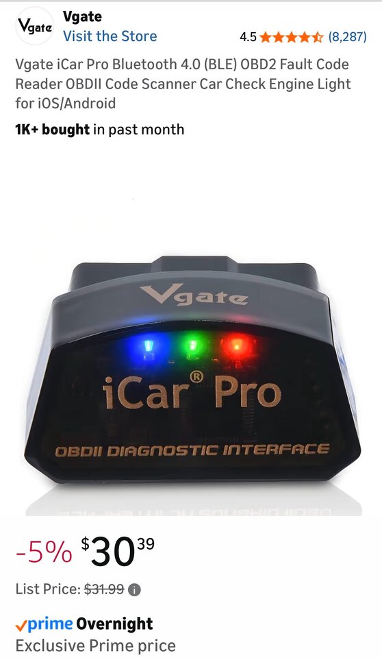

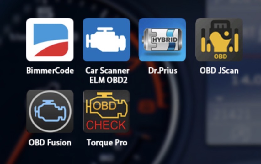

    Watching the coolant temperature is pretty easy with a low cost bluetooth elm327 obd2 interface and an app like "Car Scanner".
    If its getting hotter than 205f a bad water pump, clogged radiator or thermostat could cause pressure relief action at the reservoir.
