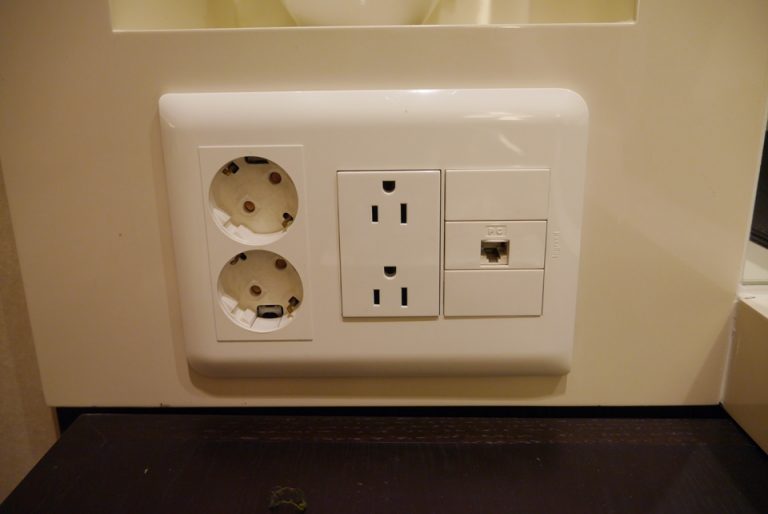

    2,779
    1,501
    Imagine if we had several different kinds of plugs on store bought electrical products within our own countries. What would houses look like?
  14. bwilson4web
    29,096
    16,533
    We already have multiple NEMA connectors:

  15. Isaac Zachary
    Isaac Zachary Senior Member
    Jan 20, 2018
    2,779
    1,501
    Yes, but at least those change due to what the device actually does. It makes sense that a phone charger and electric dryer have different plugs.
    What wouldn't make sense is if every phone manufacture had a different plug for their phone chargers. But that's the way it is with EV's right now. We have several types of charing ports, at least 4 just here in the USA. Yet they all do basically the same thing for the most part.
