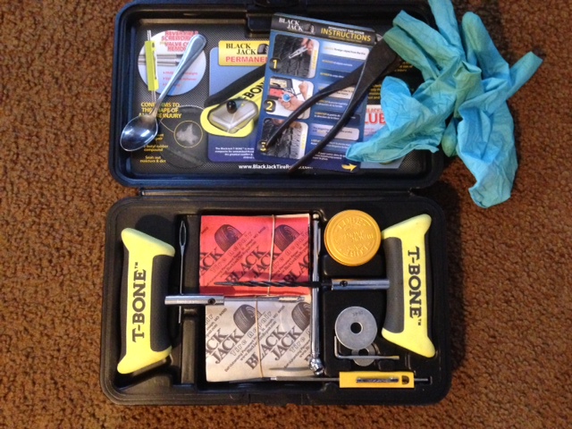

    The plug repair kit I linked (on page 1) has 2 diameters of plugs. I used the smaller diameter when I did my repair (it was a slim finishing nail). The reamer is tapered, I didn't go in too far. Worked good, no leak, about a year later.

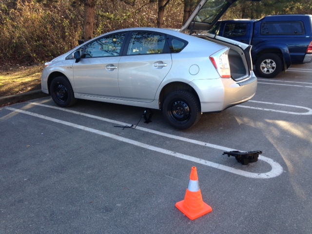

    I happened to look at the tires before we left the house, walked around, kicked them, all fine. Costco's about 10 km away, parked, glanced down at the driver's side rear tire, noticed a distinct bulge at the bottom...
    This is our Michelin X-Ice, on steel rims, no TPMS. I checked pressure: zip.
    First order of business was to go into Costco, and get me some gloves. It was about -3 C, and I knew there was no way I was going to get through this without gloves.

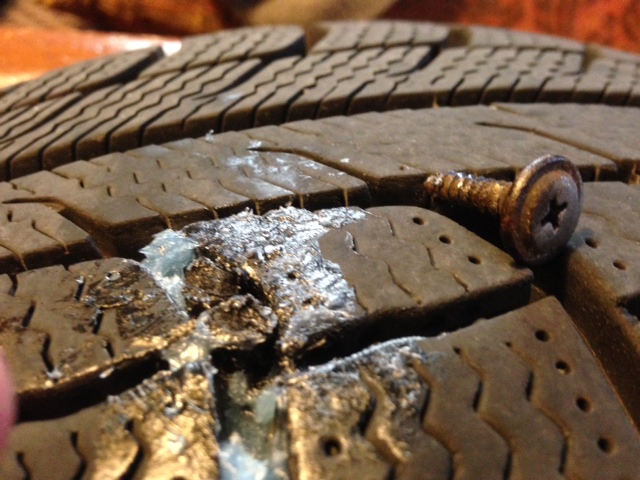

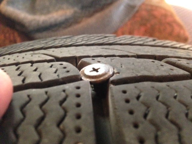

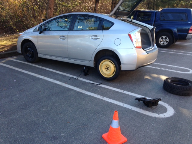

    I used the supplied jack, put the cheapo wheel chocks on the opposite corner tire, loosened the lug nuts, jacked up that corner, got the tire off and the temp tire on, it all went pretty smoothly. Right away I saw this screw in the tread of the flat: the smoking gun...
    Anyway, the full size tire more-or-less fits in the temp tire spot, except it's a bit too high, the hatch floor doesn't sit properly. By then my wife was back with the shopping, we loaded up, hit one more store, then back home.

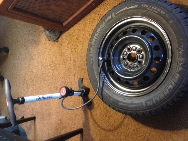

    I brought the flat inside, had no desire to work out in the cold, plug-repaired, pumped up the tire with a bicycle pump (bit of a work out, but it works ;)), soapy water showed no bubbles, woohoo!
    Back on the car, and off we went to see some Christmas displays. I was a little nervous to be committing to such a fresh repair, but it worked out, it's holding pressure just fine.
    It occurred to me, with my plug repair kit and the bicycle pump in the car, it's possible to even repair on-the-fly, with the tire just pulled off, or even on the car.

    The gold capped container is a tub of some sort of solvent you coat on things. I just needed some sort of spatula to apply it, so the spoon.
