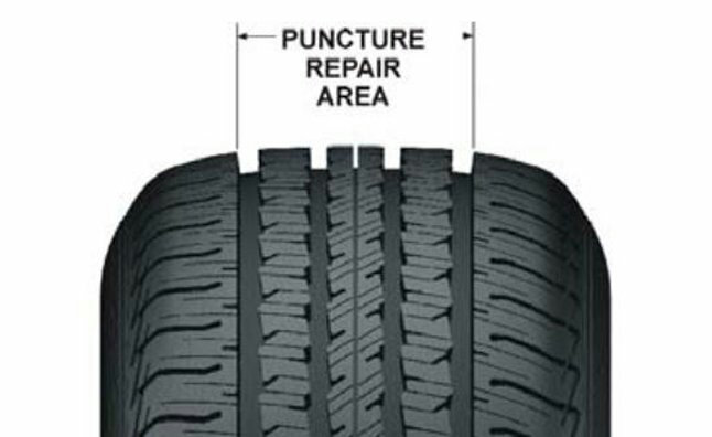

    If that's the case, most tire shops would do it... but if it is anywhere but the flat part of the tire, they won't. [​IMG] this is what most shops go by...

    its outside of that area in your photo above

    That would explain why they wouldn't repair it.

    A couple of times now I've managed to get a nail/bolt right about where the dimension line is, in the pic in post #6. The first time I asked at our nearby dealership and it was no dice, too close to the edge.
    With the first case, the wheel/tire was off the car at the time; we had our snow tires on. I picked up a plug repair kit, gave it a try. That was around 30,000 km, in Nov 2012. 30,000 kms later it's still fine.
    The second case was with one of the snow tires. Didn't bother asking the pros, just plug repaired, maybe 18 months back. Again, it's held up fine.
