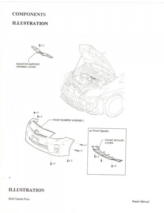

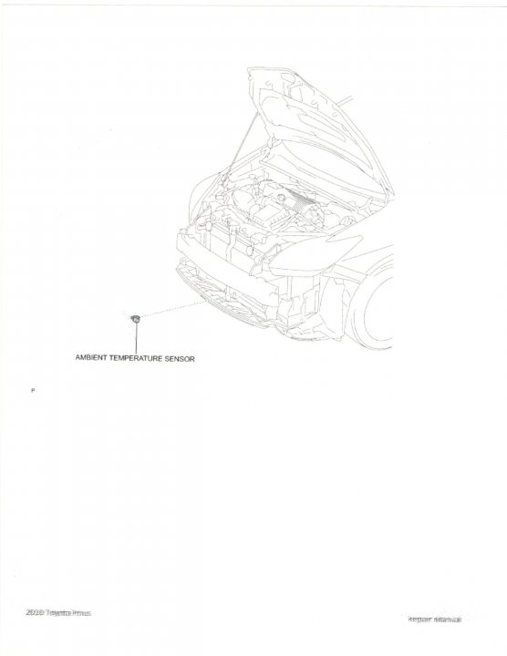

    I hit a retread the other day on the highway with my 2010 Prius. It tore the plastic cover that connects to the front bumper almost all the way off. Does anyone know the proper name of the part, I thought it was like a plastic skid plate as I want to replace it. Also the ambient air temperature sensor came off and I have no idea of where to reattach it to.

    Close enough?

    Parts 19-21 on this diagram; temp sensor, temp sensor bracket, lower shield:
    2012 TOYOTA PRIUS V Parts - AutoNation Toyota Gulf Freeway Parts
