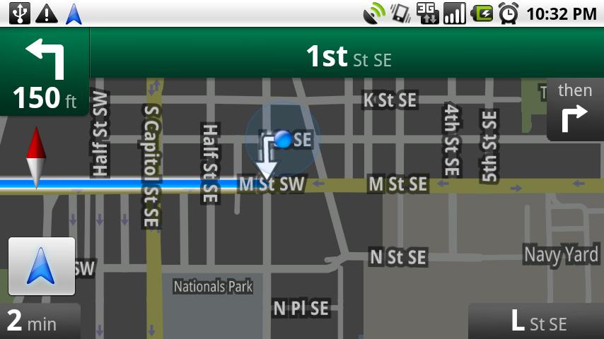

    No need to be a jerk about it. Does your nav screen look like this? grey instead of light colors for dark mode?
