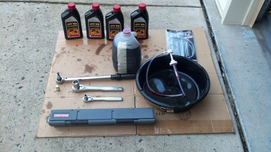

    I did the transaxle ATF WS change not too long ago. That is pretty easy too. Hardest part is refilling, pumping the little pump I bought about 150 times for each quart. I opted for that rather than a funnel and long tube to refill since I did it by myself and wanted to avoid any overfilling and mess. That Toyota ATF World Standard is good, but expensive.
    I did it at 123,000 miles.
    Wish I had done it sooner, like at 60,000. Pretty dark and a fair amount of metal deposits on magnet of drain plug .
    No problems with tranny, power and mileage got better. Attached a photo of tools, including a torque wrench, supplies and old ATF. Will probably try to do a pdf of that at some point.
    I torque everything that has a specification. I had a bad experience when my son and I were replacing the seals for the plug wells on the underside of the rocker assembly on his 1992 Honda Accord LX. Special bolt, necks down at the cover. 10lbs torque on the valve cover. He gave it one too many tugs and broke it off. Special order, of course. Great result though. Stopped the oil leak into the plug wells. Old seals were so brittle they all just shattered when I took them out. That was 160,000 miles, now pushing 200,000. Even with the bolt, probably about $30 total parts vs. dealer $800.
