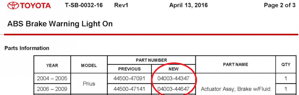

    @dolj @ChapmanF or anyone else,
    Do you know the part number I should look for? Is one of these part numbers a better, more recent revision?
    I've found references to at least 4 part numbers:
    44510-47050
    04003-44647
    44500-47141
    44500-47090
    And I found someone posted this:
    Thanks so much!

    I don't see a location in your profile; sometimes the right part number will depend on which market region the car was built for.
    On parts.toyota.com I am still seeing 44500-47141 listed for a 2006 (for the US market) The TSB you found would replace that number with the 04003-44647. I'm not sure what's signified by the change of prefix from 44500- to 04003-, maybe that is some kind of special packaged kit for replacement under the TSB. That's the sort of thing @Elektroingenieur often miraculously seems to know.
  10. Elektroingenieur
    Elektroingenieur Senior Member
    Jan 8, 2017
    2,515
    3,288
    Three Touring
    In this case, your guess is as good as mine. Toyota typically uses part numbers beginning with 04xxx- for kits, but I don’t have any more information about the parts listed in the bulletin quoted above, T-SB-0032-16 Rev1, “ABS Brake Warning Light On” (PDF), April 18, 2017.
    Neither that bulletin, nor the dealer letter for Warranty Enhancement Program ZG1 (PDF), nor Warranty Policy Bulletin POL16-03 (PDF) explains the significance of the change in basic part numbers or identifies any items, besides the actuator assemblies, that might be included with the 04003- versions. The current list prices for 04003-44647 and 44500-47141 are the same ($1,716.21).
    The primary coverage under the ZG1 program ended in 2017, and the secondary coverage is “for 10 years from the date of first use, or 150,000 miles, whichever occurs first,” by the way, so it won’t help @esskay.

    @ChapmanF @Elektroingenieur Thanks for the great information, yeah I'm CA. I did a bunch of research on the R&R and found another PriusChat member who posted a DIY method that avoids completely removing the inverter and water pump, hopefully that can make the process easier. So, to keep costs down, I just snagged a reman unit with a warranty off eBay from a seller who has good feedback on previous listings, and will tackle the work myself. Thanks again!
