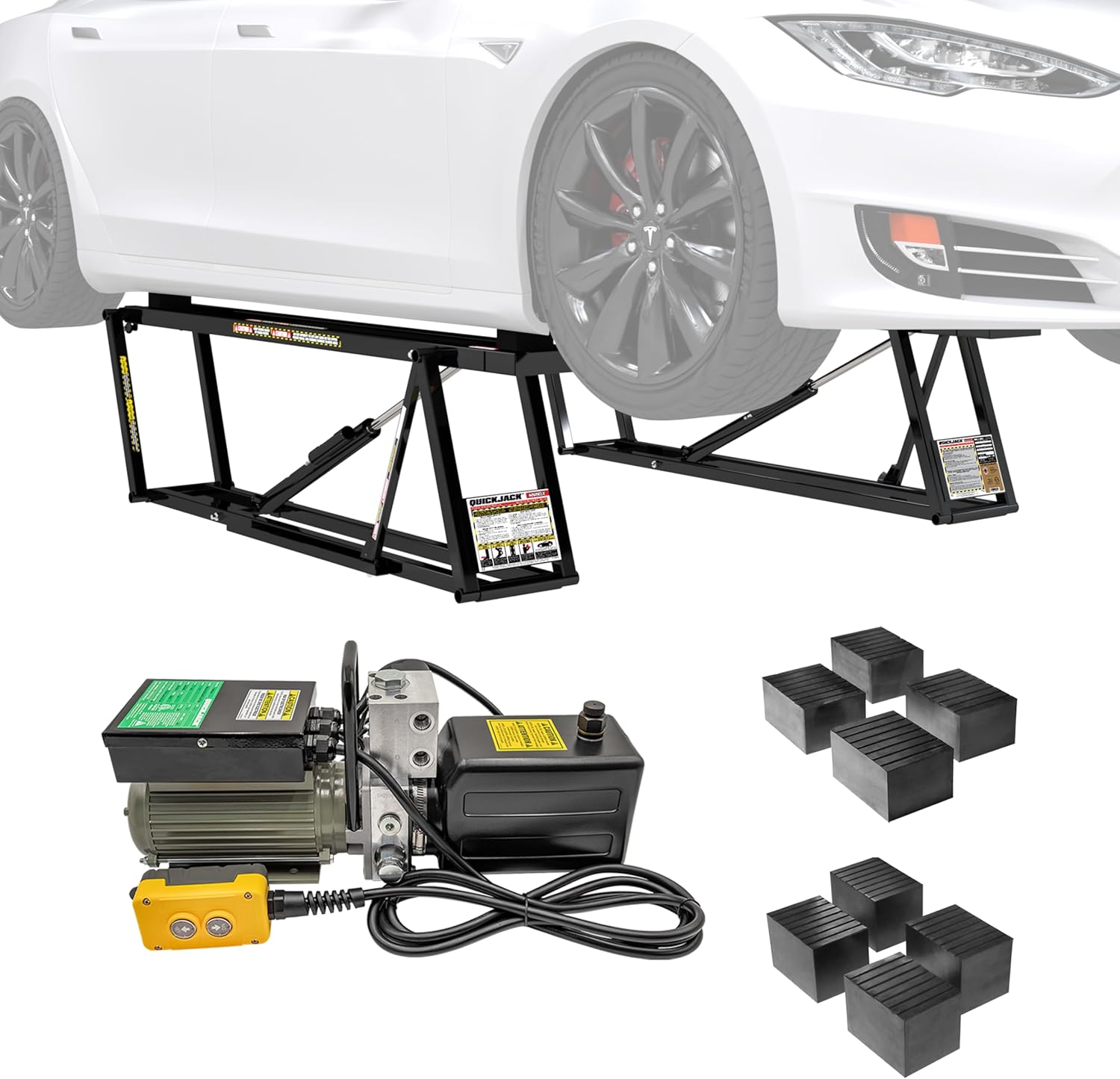

    the best answer would be car lift ramps like this, but I can't find any, and I suspect that this is a several thousand dollar solution (No accessories that cost more than the value of the car), not a few hundred dollar solution.
    The basic design you see in the picture above is that the ramp pivots on one side. You drive onto it and then use a jack to lift the front end and drop down the supporting feet that hold the front side up.
    though it may be possible to rig up something of equivalent utility using 3000 lbs rated loading ramps combined with other bits and pieces.
    And to add to the requirements, my can't-follow-instructions; love-to-complain; forgot-details-are-important boomer parents need to be able to operate the solution in my absence. Anything with more than one step in the process is an issue.

    those garage scissor lift could be fine if i can get one from the second hand market at a reasonable price (like under $500)
    But I don't know if leaving the car not on the suspension for long periods of time is a problem, nor if the several hours of salt water that the wheels, brakes, and bearings would be sitting in during flooding would be a problem.
    I also think the baby boomers wouldn't be able to operate it.

    My brother has one of those. It works great. Not hard to use either.
    Storage can be tricky. He stands them up on either side of the garage door, they are
    heavy, he's not strong, but he does it.
    You could always use it to raise the car, then put jack stands under the car, then lower it.
