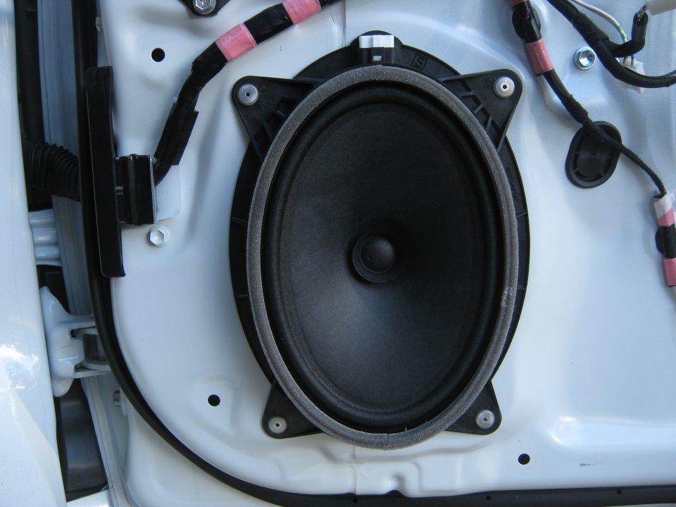

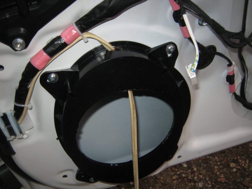

    You have a couple of options with the front speakers. The stock speaker is a 6" x 9", that is riveted in place.
    There are a couple of aftermarket brackets that can be used to mount either 6" x 9" or 6.5"-6.75" speakers in the front doors. The rear door speakers are 6.5"
    Front speaker brackets:
    For a 6" x 9" use a Metra 82-8146 adapter
    For a 6.5"-6.75" use a Metra 82-8147 adapter
    Rear speaker brackets:
    Use a Metra 82-8148 adapter
    An adapter is available to convert the Toyota speaker plug to spade plugs, if you are ever considering removing the aftermarket speakers.
    Metra 72-8104 Speaker Connector(works on both front and rear)
    Stock front 6" x 9"speaker:
    Metra 82-8147 adapter for a 6.5" speaker:

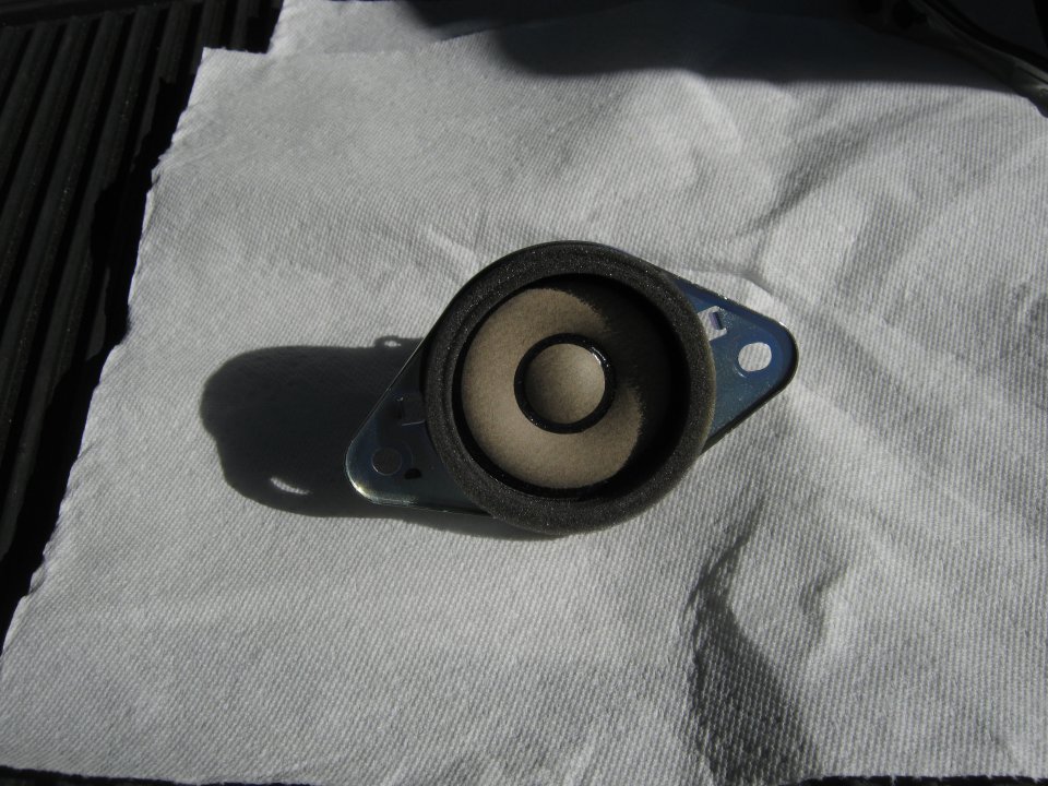

    Dash speakers are 2" speaker with enough space to allow a 3"-3.5" speaker to be mounted(if you are creative with Dremel tools and a small amount of metal/plastic fabrication) to enlarge the opening and to create a mount.
    Easily accessible by removing the A pillar panel, the panel next to the dash(near the small triangular side window) and the speaker cover. There are two small bolts holding it in place.
    I'd recommend disconnecting the battery before you remove the A pillar panel. There is an air bag located underneath, near the top.
    I do believe the dash speaker is wired into a series circuit. I have disconnected the dash speaker and you lose power output to the front door speaker if you do not re-connect the wires together.

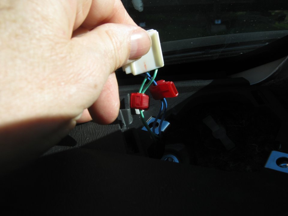

    Here's your crazy talk... :p
    Have you accessed the tweeters in your car?
    I have.
    Disconnect your tweeters and see if your front door speakers work.
    Mine didn't. I had to attach wire taps to complete the circuit.
    If the tweeters were in parallel, disconnecting them would still allow output to the front door speakers.

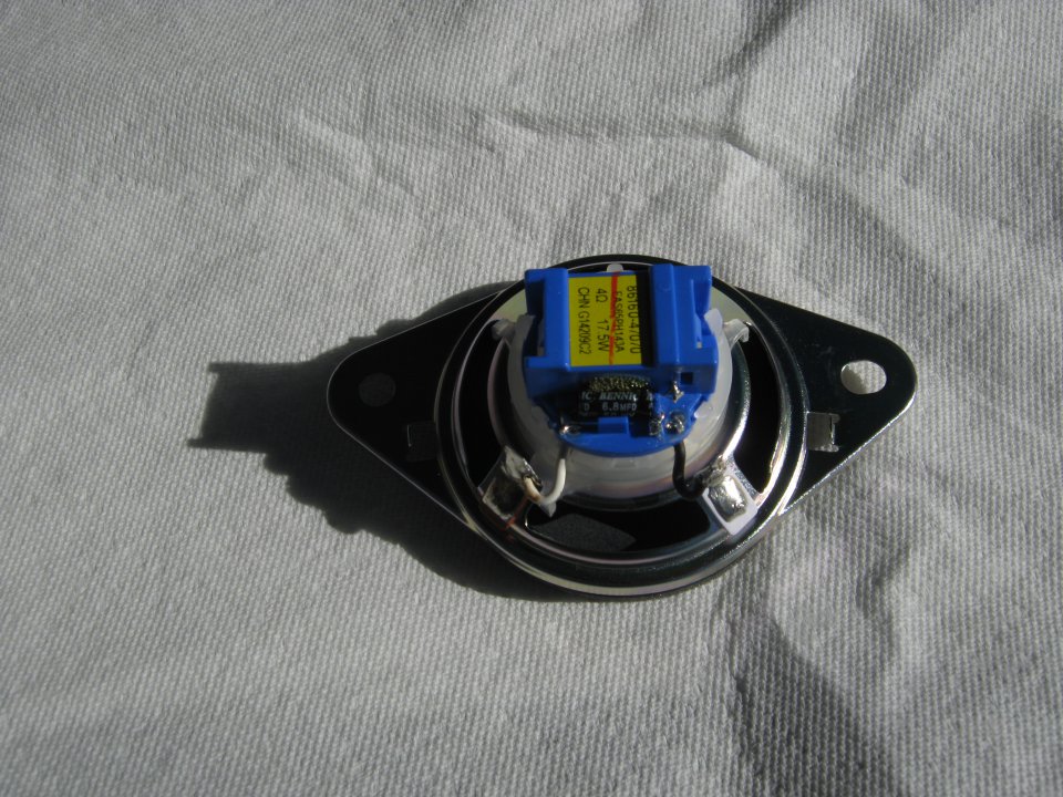

    If you look at your third picture, you will see 4 wires. If the speakers were in series, there would be only 2 wires.
    You should also read about the 'bass blocking' non polarized electrolytic cap that is in series with the dash speaker. It only allows high frequencies through.
    You are not disconnecting the dash speakers; you are disconnecting a 4 pin connector that has the dash speakers on the other end.
    If you search priuschat, you will find wiring diagrams, all of which show the dash speaker IN PARALLEL with the front door speakers.

    In either case, you will want a much bigger 'bass blocker' cap than the OEM one. If I recall correctly, the polks come with one, which is a nice feature. You might want to add a series resistor, as the dask speakers are louder than the door speakers, and to educe the low impedance load on the head unit.
