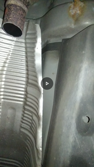

    I've just taken one last video and got a shot of something that looks cut off.
    See pic below:
  8. Mendel Leisk
    61,482
    42,305
    Uh oh...

    Your cat looks like it’s missing to me

    I'm gutted and so angry.
    These thieves go round and steal from the poor.

    Is this cat converter the same as the one I had - but maybe minus the precious metals?
    Let me know.
    Thanks.

    I'd check with a local specialist if I were you. I feel like the bar for passing MOT (I am American and have no direct experience) is relatively high and you wouldn't want to waste your money with a solution that wouldn't get you a pass.
  16. bisco
    115,365
    52,807
    agree. you need local expertise. over here, it is state by state regulation.
