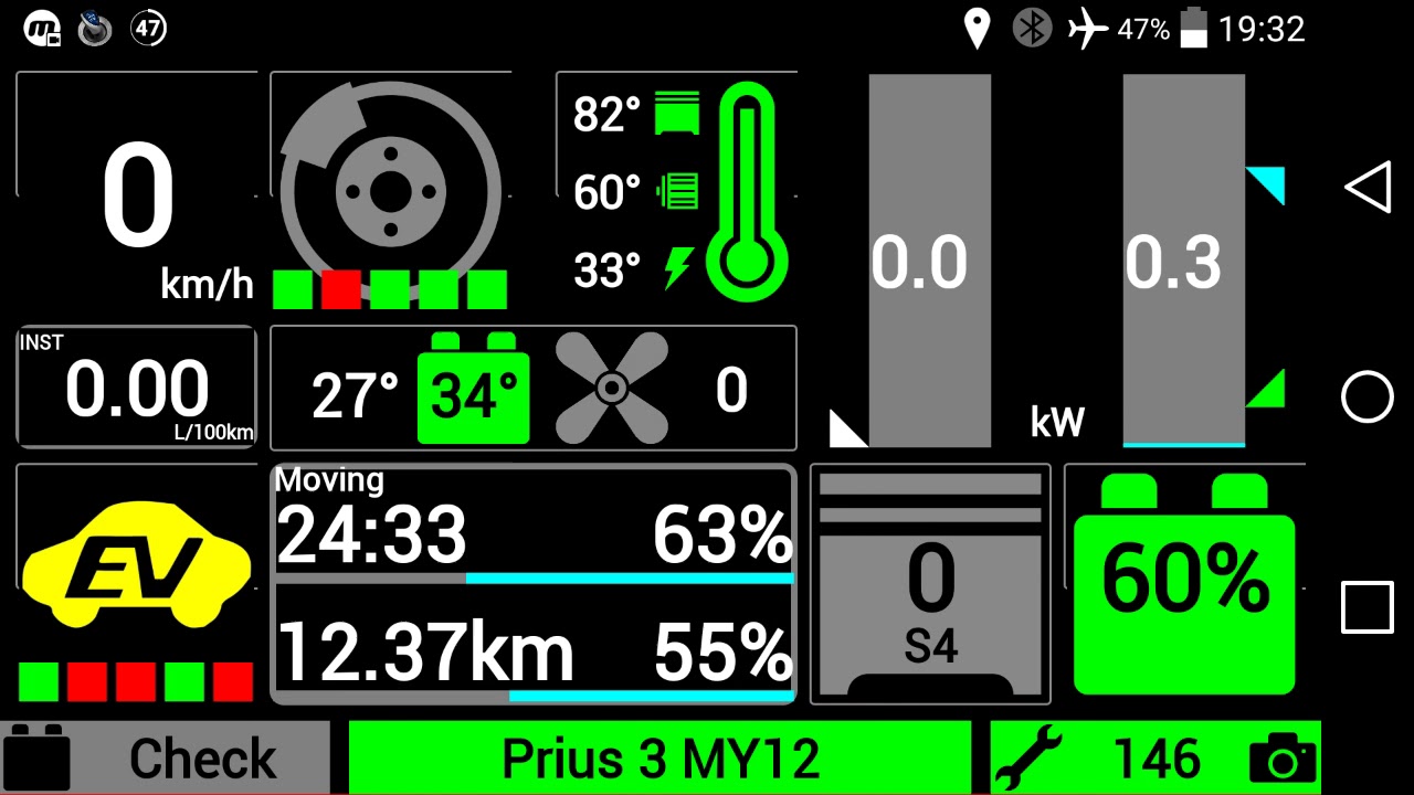

  19. abubin
    abubin Member
    Dec 7, 2019
    193
    92
    Malaysia
    I find hybrid assistant to be most comprehensive with it's readings. It might not look "pretty" but if what you want are reading, it is readings you get.
    Another important feature that hybrid assistant and dr.prius provide is the HV fan speed control. I set it to 35c when I am driving because it will increase the fan speed for better cooling. In a climate that is always freaking hot here, it is an important feature because keeping the HV batteries temp low is important in preserving longer lifespan.
    Oh, BTW you do get to see the coolant temps if that's what you are after.
