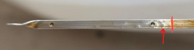

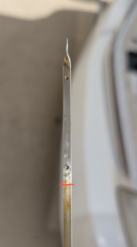

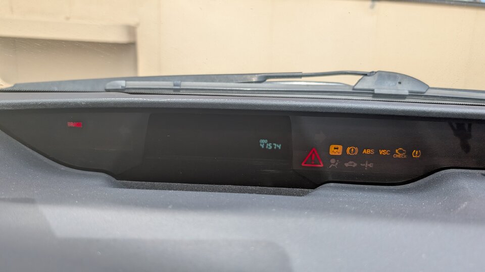

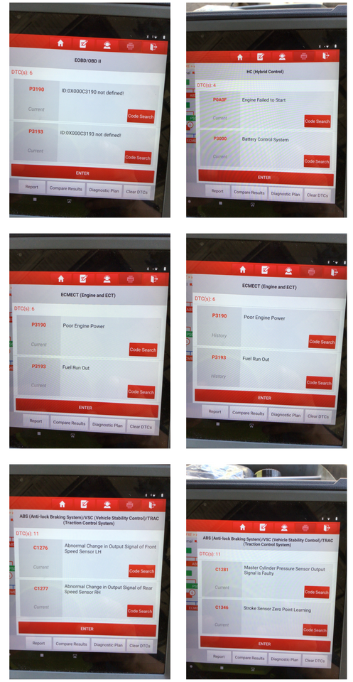

    I am in Houston, Prius 2008, 141000 miles. I had my car oil changed at midas, after that I drove 3 miles and my engine got shut off. All the warning lights started coming up i tried turning off and on several times but engine would not come up. (When we start the car 0 mph does not come up)

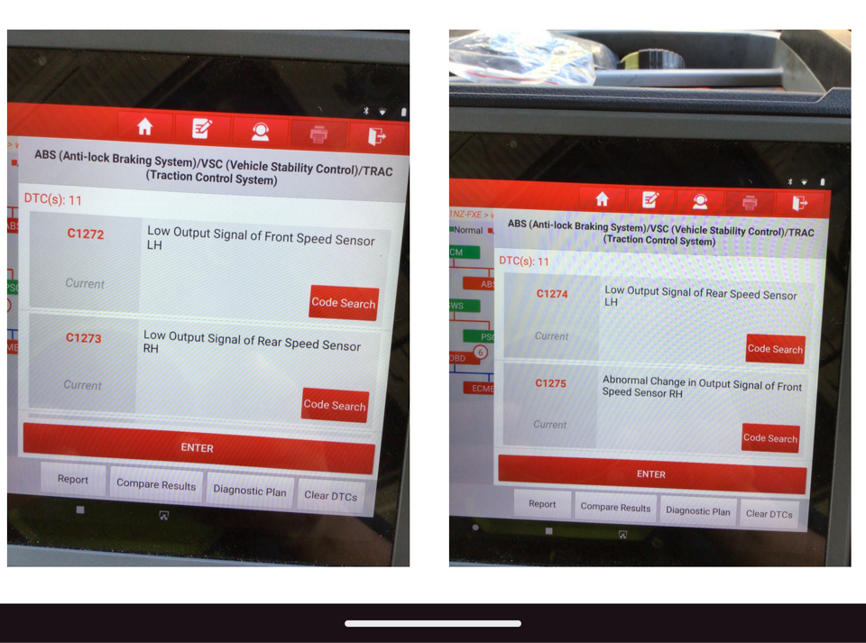

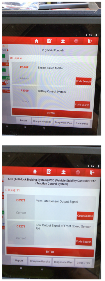

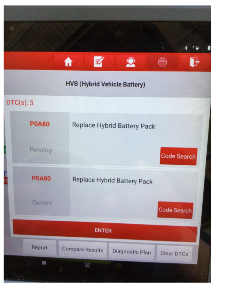

    I got it towed to one mechanic place and they found some error codes as attached. And I tried checking the oil level it was above the high bar as you can see in picture. As per the codes, mechanic said my hybrid battery is down and that is the reason my engine is not starting. So, they will need to change hybrid battery for 2400$.
    12V battery is fine. There was one error of low fuel and I tried putting 3-4 gallon of fuel as well.
    My doubt is oil level is above the high point. And maybe people who changed the oil put different catagory of oil but bill says 5w30.
    What is the brake light suggest and what can be the problem? Any help will be appreciated. markup_1000032975.jpg PXL_20250627_213729637.jpg markup_1000033116.png markup_1000033114.png Screenshot_20250703-140345.png markup_1000033117.png

    this is a shot in the dark diagnosis, if you have a capable scanner for Prius (Autel MaxiAP or others) clear the codes first, it will at least clear the hybrid battery error temporarily. The codes indicate issue with the engine not able to start and several tries probably drained the HV battery.. note that since the engine is running the HV battery is not charged.

    plus 1 on the Autel... It is a necessary tool. Also do a search here for hybrid coolant pump. Under the hood open the cap with the car in READY mode. You should see the pink fluid swirling around....if you don't your pump failed.. This happens about 100k miles.

    I personally don’t think your trip to midas for just an oil change caused this, nor the oil level being above the specified full dot (did you check the oil right after car shut off and take this photo?). I have ran my prius with similar amount of oil in the engine by over calculating the fill and it is 100% ok. My brother even drove around for weeks with almost double the amount of oil and nothing happen to his prius not that id sayi its ok).
    Did you ever have any symptoms to any of these issues prior to the oil change visit? If not, its pretty suspect that all those lights and error codes came on out of nowhere with no previous indication as they are all over the place, Engine, fuel, HV battery, Master Cylinder etc. Perhaps your fuses, check the AM2 fuse on the fuse box and check the inverter coolant pump as suggested by user above. Its too many things to check with all those issues IMO but also check the rear connectors close to the battery and its dedicated fuse (I believe its a 5a).

    I'd say the oil level is where I've marked with an arrow, looks ok:
    Even at your mark, not too serious.

    This oil level photo is after car shut off. And I did replaced coolant pump 6 months ago. Will try checking fuses.

    What I am asking is how long after shutting the car off was the oil checked? I dont want to make assumptions but just in case, oil is to be checked after vehicle has been of for at least 10-15 minutes, not right after since it the oil hasn’t had time to settle completely and you can get a false reading (just in case). If it was checked in that manner then, yes the oil level should show accurate level on dipstick.

    The issue of the car not starting is not being caused by the slightly higher oil level or the viscosity of the oil added by Midas.
    In addition to what I already suggested in post #2, look for a vacuum hose that is loose or that has come off.
