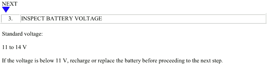

    Attempted to do the maintenance mode steps but car won’t go into ready state. Ran the code reader again and the report showed the 12v battery at 11.25v
    Put the car in self function test and the check signal button shows 12v at 11.6v
    The car lights and dash turn on no problem and don’t seem to dim out. Tried to “jump start” battery hoping to charge battery up to 12v with no success.

    Your aux battery is low on charge, but not low enough to stop you from reading current codes to find out why your car is choosing not to go READY.
    That's what would be my next step, before shotgunning parts. Generally when the car decides not to go READY it will be happy to tell you why. As you observed yourself, $250 would be quite a bit to spend on a shotgunning approach.

    That voltage is very low. Wouldn't hurt to try a charging session, with a 3~4 amp smart charger, but probably replacement time.

    The voltage is above Toyota's threshold for retrieving codes, and the P0A0D code shown in current status is the car saying right out loud, "hi! I am not going to start, because you have left the safety interlock circuit open, and I am programmed not to start then."
