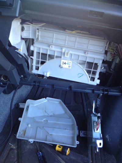

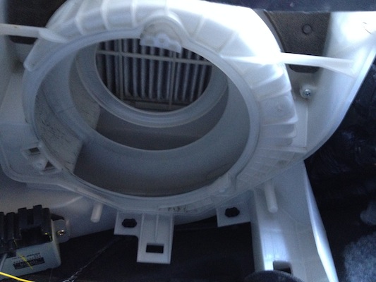

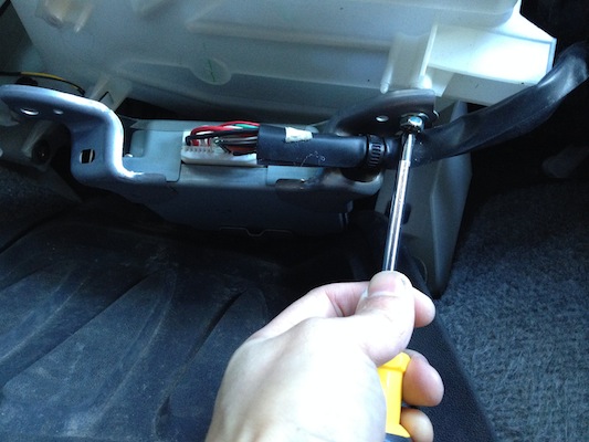

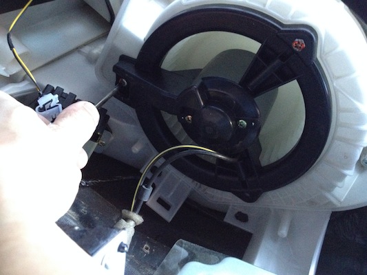

  11. aronaut
    aronaut Junior Member
    Nov 13, 2013
    This is a notorious problem and an easy DIY job. My blower fan (2008 Prius) started going bad about a year ago, I would have to kick under the glove compartment to jumpstart it. I bought a replacement fan online for $50 - removing the old one and installing the new took 30 min. Before installing the new one I compared the two fans, powering them with my workbench power supply. The old one required a lot of amperage to get turning, or I had to physically spin it with my hand to jumpstart it. The new fan started right up with low amperage, this proves that these fans wear out over time or the motor brushes get dirty.
    Tools: 1 phillips screwdriver, 1 size 20 star driver (or use small flat head)
    To take out the old fan remove the glove compartment to reveal the white plastic fan housing and filters (while your at it clean or replace the filters). Then remove the kick plate down by the floor mat (it snaps out). behind the kick plate there is a metal transmission control unit held by 2 philips screws to the fan housing, remove this. Then remove the entire bottom plastic plate of the fan housing, it is attached by 5 phillips screws. After removing the screws you have to kind of wiggle the plate out of there. with the plate gone you have access to the blower motor, it is attached by 3 star head screws, remove them and pull the fan out and unplug its wire harness. That's it, just install the new blower fan and put back together. works like new.
    Here's some photos of the job:
