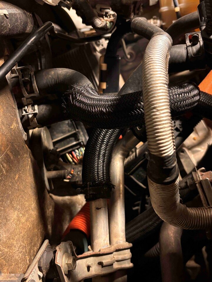

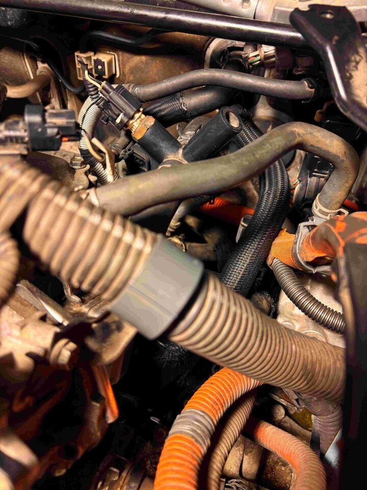

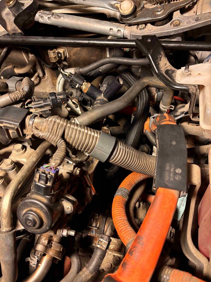

    Hi @Sergey K and others: Very enlightening discussion! My situation maybe slightly similar, but not quite. In my 2013 Lexus CT200h, it rattles during idle, coolant temperature becomes much higher in 15 min, and coolant begins to overflow out of small opening underneath reservoir cap. I have written down some details below. Please give me some ideas on what to do next. Thank you!
    Already performed below on my 2013 Lexus CT200h (~157000 Miles):
    1) Headgasket job
    2) Valve
    3) Fuel Injectors replacement
    4) Spark plug/coil replacement
    5) Egr, Intake Manifold cleaned
    6) No OBD codes, no code for water pump or anything else hence did not replace it
    7) Coolant does not seem to be leaking into cylinders
    8) Engine oil is clean

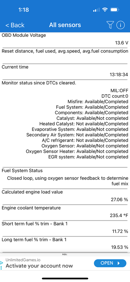

    Issues post all above job: Below happens while starting car in Maintenance Mode
    1) Rattling during idle
    2) Noticed Coolant temperature went to 235 deg F after idling for about 15 minutes
    3) Then Coolant overflows from reservoir
    4) If I press accelerator, engine sound is normal
    Questions:

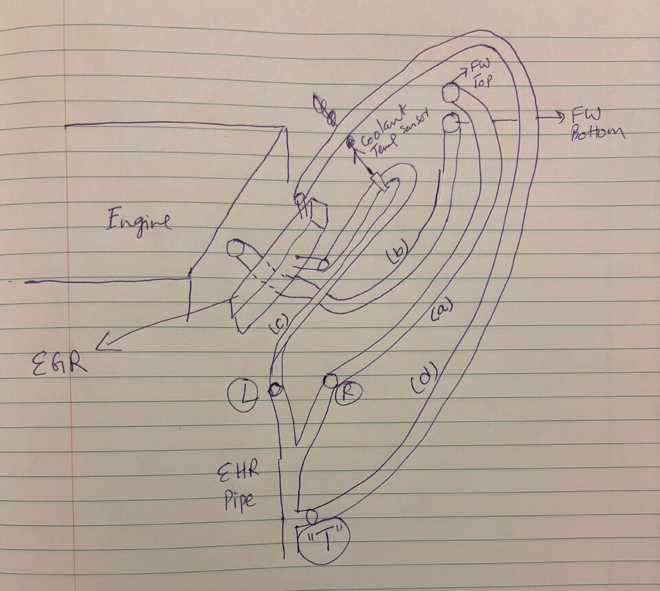

    1) I may have connected incorrect hoses. Could not find documentation/drawing anywhere. Please correct me:
    (a) Currently firewall big hose on top is connected to EHR Pipe Right Opening
    (b) Currently firewall big hose on bottom is connected to Engine underneath EGR
    (c) EHR Pipe Left (Passenger side) hose is connected to EGR Cooler
    (d) EHR Pipe bottom ("T") hose is connected to EGR
    2) What could be the issue? I have done everything I could think of and have spent lots of time. I do not think engine is knocking and coolant does not seem to be leaking into cylinders. Engine oil is clean. This has been extremely frustrating, do not know what to do next? Please help! Thank you so much in advance!

    Does it overheat when driving?
    Do you see the coolant flowing in the engine coolant reservoir? It should around 190f and may require a led light on the plastic to see flow.
    Does the temperature alert light come on?
    Do the radiator fans come on while it is overheating in maintenance mode??
    Normally in maintenance mode you should have the ac off.
    Normally a second hg problem will not cause an overheat assuming the coolant is full but could cause the rattling.
    Assuming no head gasket sealer was ever used, I would certainly remove and inspect the engine water pump and thermostat.
    The big radiator to engine hoses are what keep the engine cool combined with the water pump and thermostat.. The radiator must flow and the radiator fans must operate when the car is not moving. The rest of the coolant hoses could be blocked without overheating the engine.
    >>> Yes, light came on when temp went above 235
    Normally it comes on at 248f unless you have a water pump code, many of which you can't read with a cheap scan tool.
