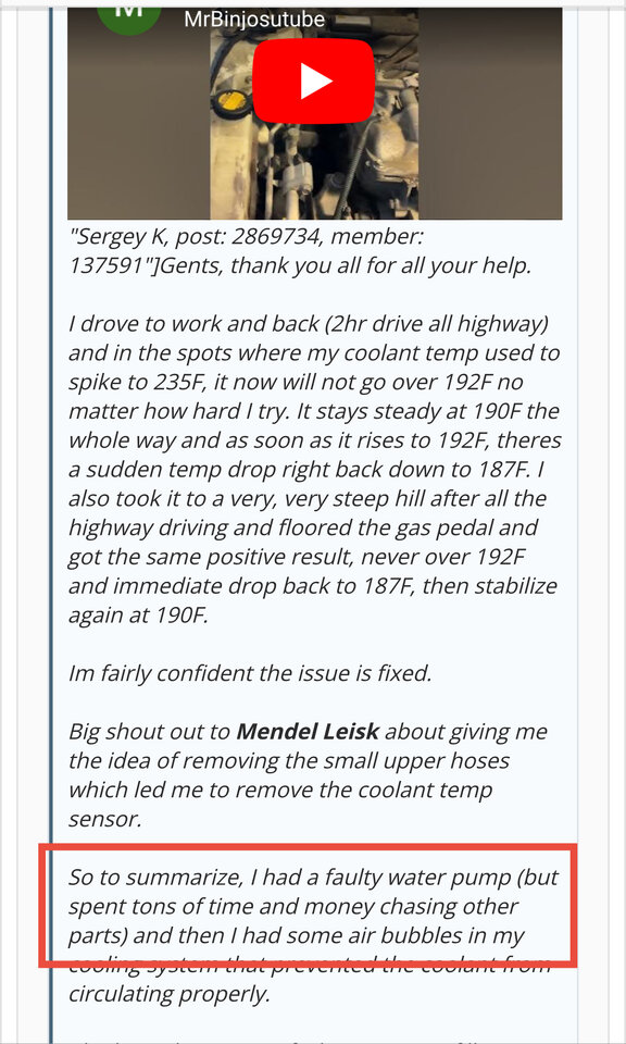

    Thanks again @rjparker !
    The video I posted originally is the video I took of my car while in maint mode. There is no note below the video saying changing water pump fixed the issue, because I have not changed it yet ... had not even thought about it until you mentioned. I recently replaced spark plug, coil on the cylinder 4 with non oem bought from Amazon. I also replaced all four fuel injectors and MAF sensor, non oem from Amazon. I just wanted to see if that'd make any difference, as previous to that I was getting P0304 and P219A.

    Ok I guess I read your post 229 differently.

    Clearly there is a rapid onset overheating problem, usually the water pump. We don't know if you see reservoir flow or if the radiator fans come on. Based on a lack of fan sound they are probably off. We don''t know if you have a scanner capable of advanced Toyota codes or bidirectional testing capabilities.
    The overheating is priority one if it's not too late for the engine.
    Video:
    You have an engine with a diy hg but the repair was never satisfactorily completed. In the video it runs reasonably decent for 60 seconds with a very slight roughness so we know it's actually running, We don't know if the engine just started from cold or was already warmed up.
    It suddenly stalls and automatically restarts while continously rattling the damper badly, apparently due to misfires, egr stuck open or timing.
    The odd thing is it seems to run smooth when rev'd up but not when allowed to idle again. You repeated that cycle three times.
    With the engine cold, I would do the egr blocking test to determine if you have a stuck egr. Egr flow is designed to be fully closed off at idle. It will cause roughness or stalling if opened a little or a lot at idle. At higher rpms the engine can take egr exhaust flow and run normally.
