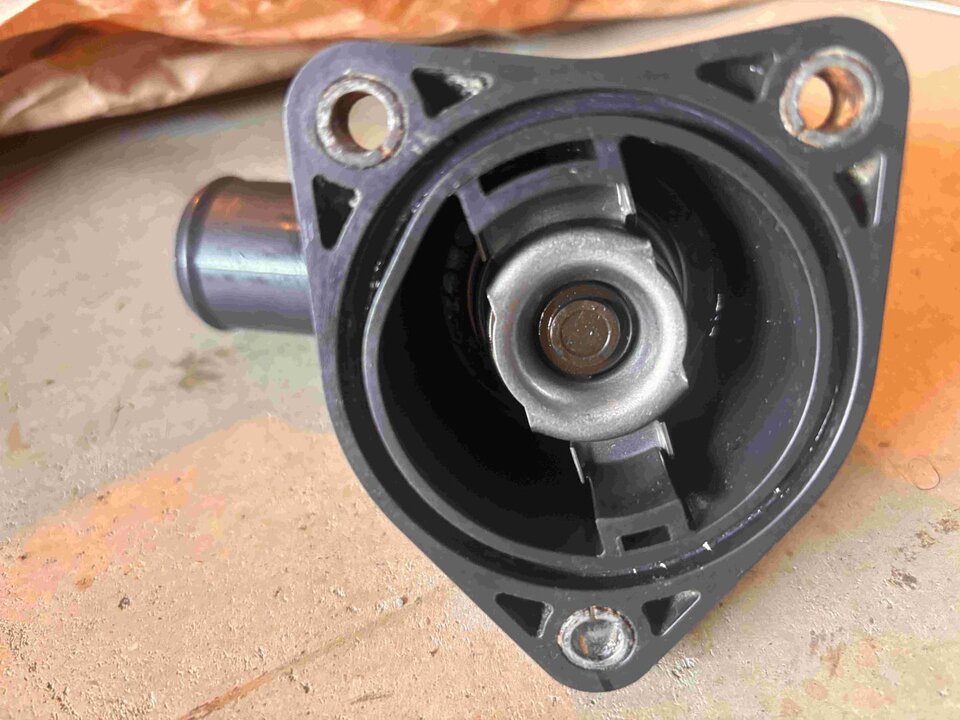

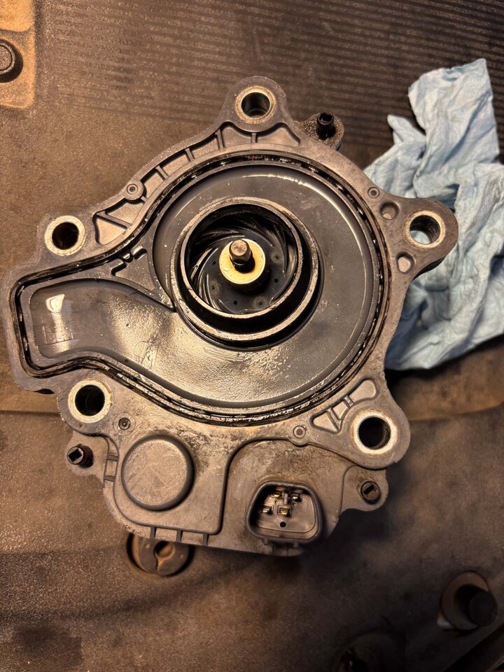

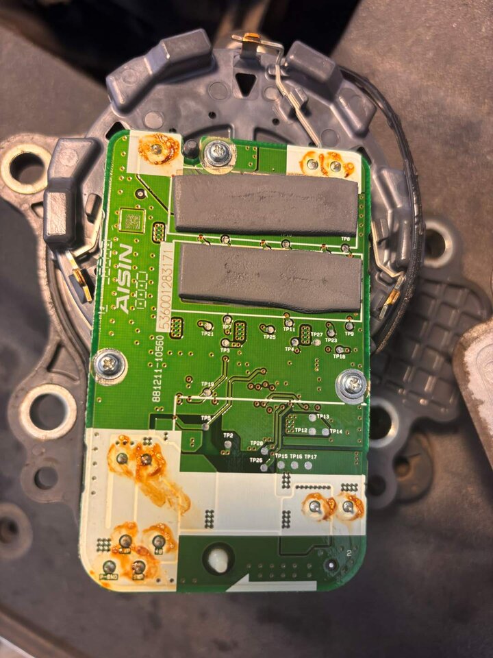

    You're spot on! The issue is 100% Water pump. Today I removed both water pump and thermostat. I could barely rotate it. Thermostat - I am not sure if it is faulty. It looks ok. Below are couple pics. Is there a way to check thermostat? I also removed cooling fan relays, all three of them. When I used multimeter to test them, all three looked fine. So, not sure how to diagnose radiator fan issue? Could it be Cooling fan switch/sensor? Do you know where is it located? I googled and tried to find troubleshooting method and location of the switch/sensor but have not come across any useful info yet.
    I had thought about replacing engine couple months ago, just nervous about it since I have never done it. I have watched many videos, I think it may be possible. Before deciding to do that, I wanted to rule out other parts. Are you in Houston? Which part?
    Now, I need to decide whether to try replacing water pump and thermostat or just replace engine (knowing that both components will come attached to JDM engine). If replacing the water pump and thermostat makes the car drivable, it'll definitely be worth it. Otherwise, I'm not sure ...
    Thanks so much again!

    since you have the thermostat out, you might as well replace it.
    With a Toyota OEM part. Same with the coolant pump.
    Yes, they cost more, but you know they are the correct part and not chinese copies.
    When you fill the coolant, go very slowly, only a cup or two at a time. And wait 10-15 seconds,
    then add more. That will allow the coolant to push the air out. It will take longer, but you won't
    have to waste time and fuel trying to get the air out.
    Fill the tank to the "B" mark.
    Then start the car, and wait for the engine to start, and wait until it shuts off on it's own.
    Then check the tank, it's probable close to the full mark, top off if needed.
    Then drive the car for 10 minutes and try to keep the engine running. Return home, shut it off, park it as
    level as you can. Then clean up and check the coolant level. It's likely at the full mark. I like to put it
    just over the full mark so I can see it. It will go up and down as you drive it.
    The coolant fans probably didn't come on because the coolant pump wasn't circulating the coolant so the
    sensor never got hot enough. And even if the did, it wouldn't help if the coolant isn't flowing.
    I'm glad you found the issue!

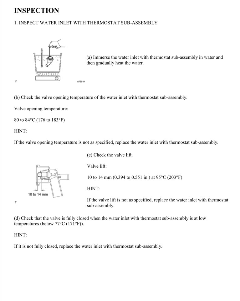

    Given you have the water pump out I would change it with oem. Most likely the thermostat is ok but you could take it out and watch it open in hot water.

    I would just get the replacement thermostat, they're not that much. What I've done, mostly for curiosity, was to suspend both the old one and the replacement in a pot of water on the stove, plus a thermometer. Then watch them as you bring the water to a boil. In my experience (with another car), the old one started to open sooner, was fully open sooner, and the rubber gasket appeared less flexible/harder, and had some edge fraying.
    Ah, just noticed @rjparker's pic, up the page. :oops:

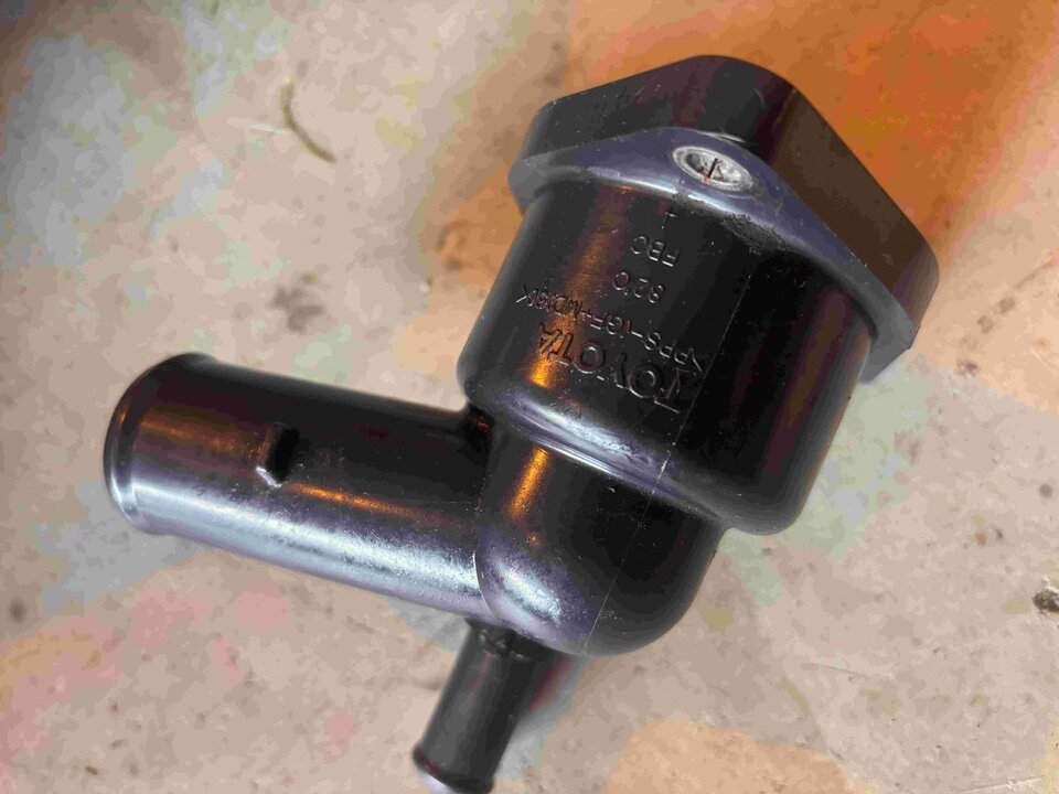

    1) Replaced water pump, could not replace thermostat. Bought AISIN TStat from Amazon and they sent different brand. I tested my Tstat in boiling water, and valve opened up. I was being impatient, so decided to use the same old original for now.

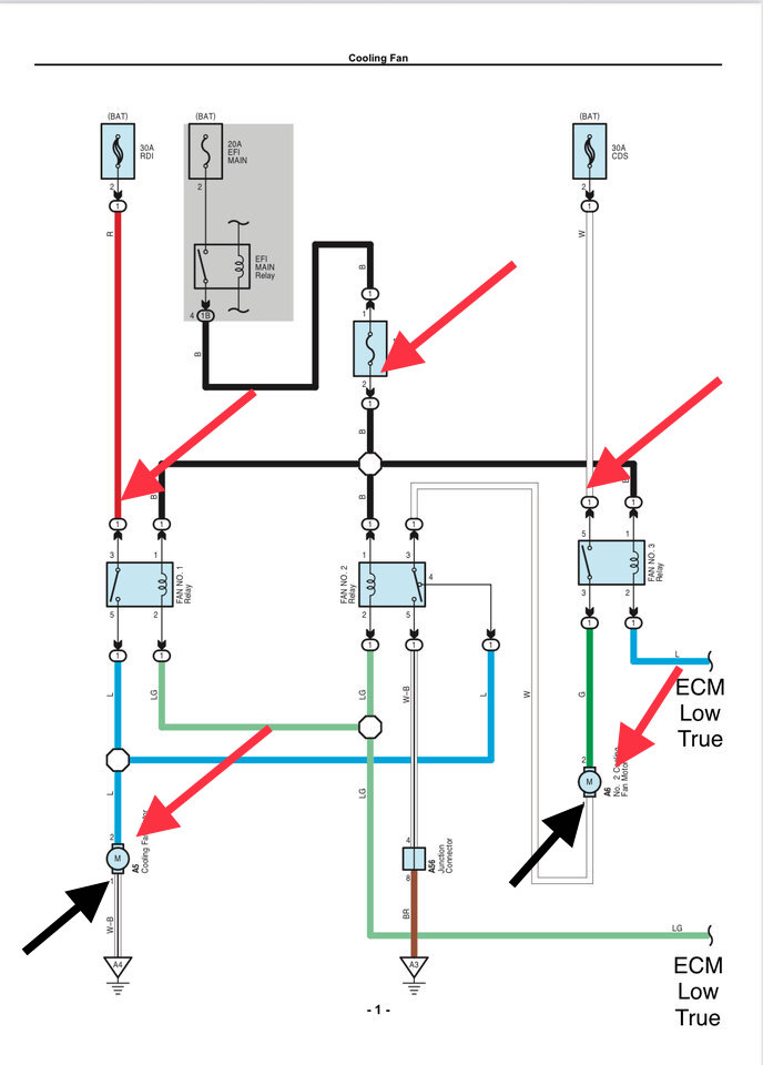

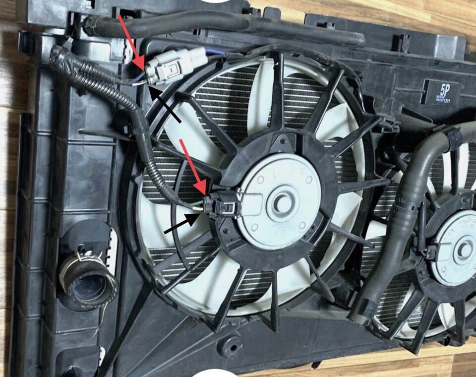

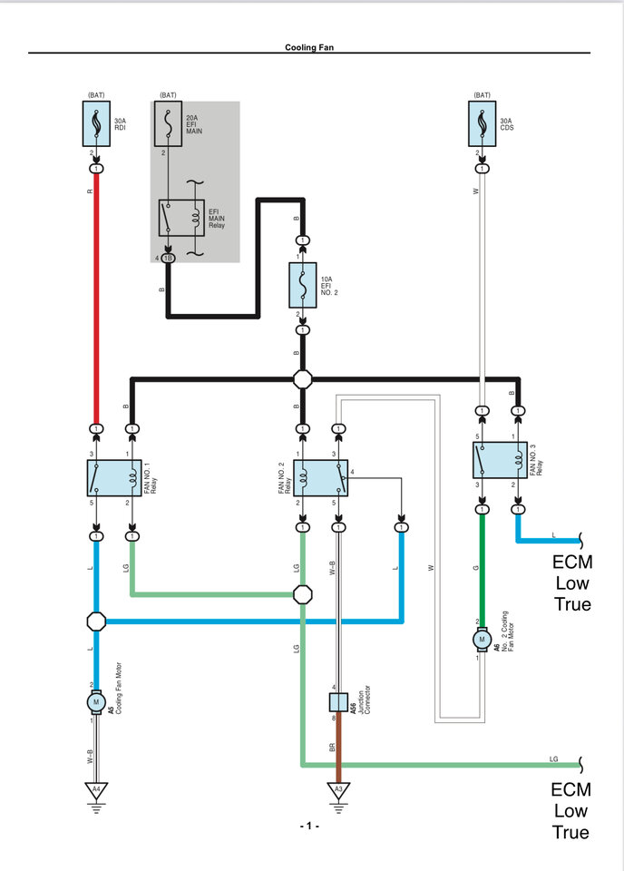

    You need to check the radiator fan circuit with a meter to verify if power is getting to the fan motors.
    Check at these relays, fuse and the motor wiring connectors while live. 12 vdc to chassis at the red arrows above except for the fan motor connector where you measure across both pins to verify power and ground. AC on to force fans on or better yet Techstream or other bidirectional scanner to force them on.
    I believe you have a blown head gasket at minimum and the engine could be burning coolant.

    @rjparker : Thanks for the circuit diagram. I think I sort of understand this. It looks somewhat difficult to disconnect the wires to the fan motor connectors, but I will try. Do I need to pay for subscription of techstream? Is there a free version out there?
    I think you may be right, headgasket job may have failed. Below is a small clip I took earlier that shows how car sound while idling in maint mode, and how it sounds while hybrid battery is charging:
