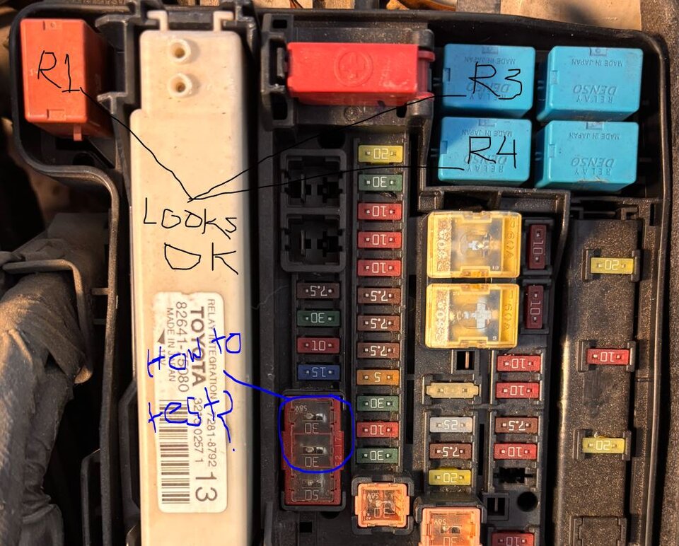

    30 AMP RDI & CDS fuses you mentioned are in blue circle in the image. Just remove it, and visually check it + use multimeter to test continuity? I had previously checked each and every fuse except for these three since these are joined together. Thanks again @rjparker !

    I just checked all three fuses ( 2 30A, and 1 10A), and all three checked out. There is continuity. Next I will check fan wiring connectors soon as I figure out how to reach and disconnect these.

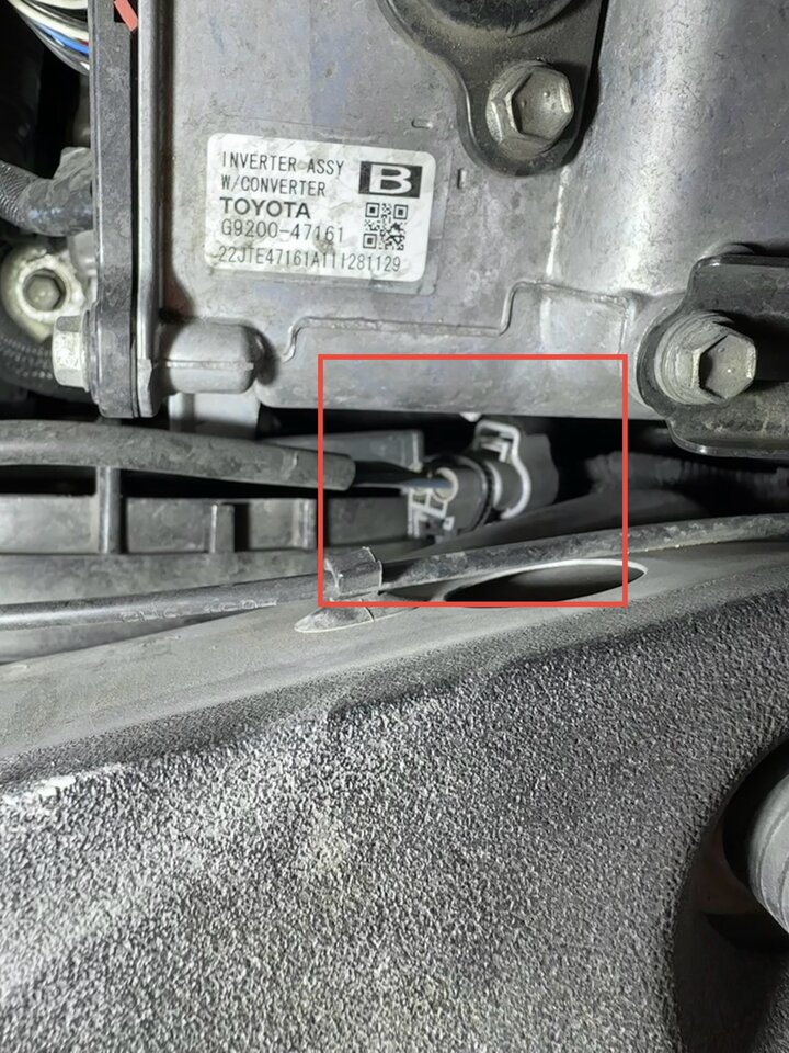

    The radiator fan power for one fan is accessible between the inverter and fan assembly on the driver's side. It should be possible to back probe that connector in place. I would set the meter for dc volts (in a range to measure 12-15 vdc) and use very fine probe tips, ideally needle probes.

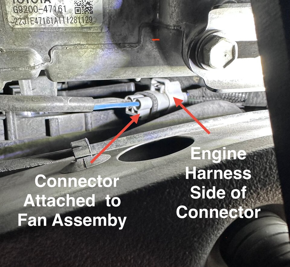

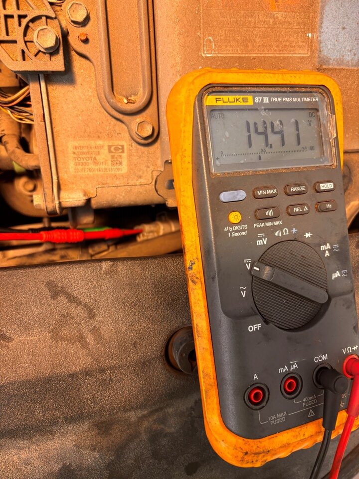

    Good Morning @rjparker : This morning I was able to do a bit of testing just like you suggested. I also referred to the service manual that I had downloaded a few months ago. The voltages checked out on all three fuses, relays, as well as to the connector. I tried directly connecting the the driver side fan to the battery. I was measuring voltage while doing that and could see 14.41V, but the fan did not operate. This looks to be the fan motor issue and the fix looks to be replacing both the fans. Please correct me. Thanks again!
  11. ChapmanF
    28,719
    19,019
    It looks like a strong indication for replacing that fan, anyway. It may be worth testing the other fan the same way before concluding they are both bad. Also, even for the fan you brought power to, there can still be questions about just how you tested.
    When you measured 14.4 V at one terminal of that fan, where was your meter's ground reference? Keep in mind that one of the fans (the one with the green supply wire) does not return directly to ground, but to a relay that switches it either directly to ground (for high-speed operation) or to the supply of the other fan (for low speed). So if that was the fan you were testing, your test might not be telling you what you think, unless you also had energized the "fan no. 2 relay" (or removed it and jumpered the socket positions 3 and 5).
    LexCT200H and Brian1954 like this.

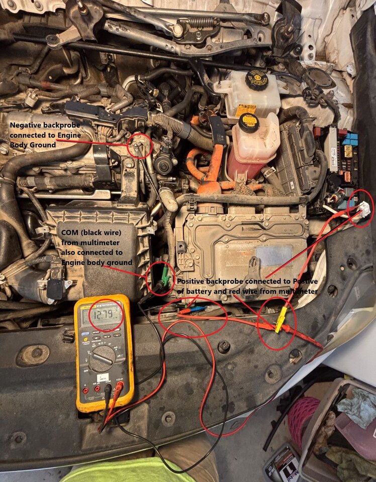

  12. LexCT200H
    LexCT200H Junior Member
    Mar 8, 2025
    51
    Houston
    @ChapmanF : Thanks so much for guiding me!

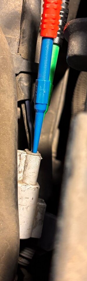

    I backprobed into +ve terminal of the connector and connected with +ve of battery. Backprobed -Ve terminal of the connector and connected that into Engine body ground. I then connected +ve of multimeter with backprobed +Ve of the connector and -Ve of multimeter with the engine body ground. The multimeter was set to V (DC), I did not disconnect the fan terminal connector (difficult to disconnect, I know I'm being lazy, hence the reason for backprobin). Next test I do I will try to disconnect the driver side fan, and if possible passenger side fan as well. I will then test both the fans directly connected to +ve & -ve of a standalone car battery. Attached is the only photo I have, should've taken more. Thanks again!

    Overall it seems odd both fans would have failed but since this car is new to you and has never run right, there is no telling what happened to it.
    It is possible the plastic fan blade(s) are jammed against their housings. I would verify the blades rotate freely. It may require a wire from the top or access from the bottom. I have seen one jammed blade.

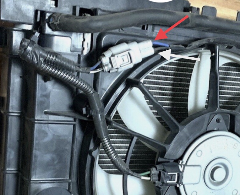

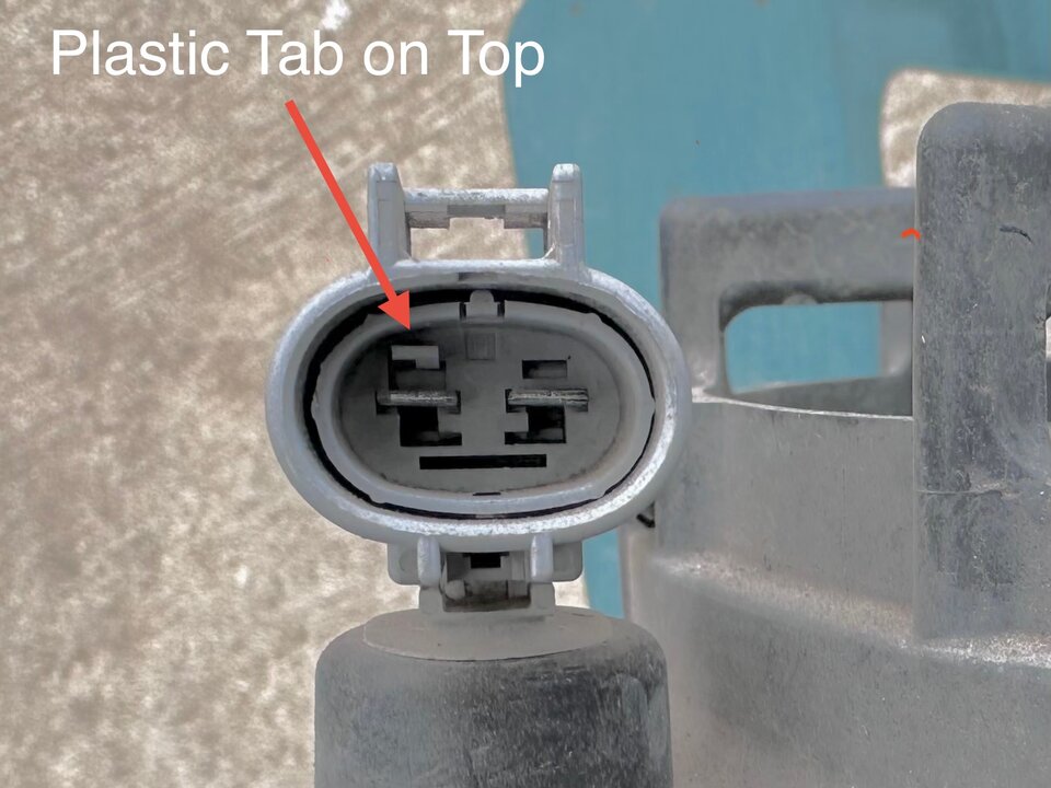

    Assuming you tested the accessible connector on top with Blue (+12v) and White/Black (Gnd), that motor does not have a switched ground. It drives the passenger side fan. If you measured with both leads at the connector then your tests seem valid.
    No fan after applying power is a pretty good test. You do want to ensure you applied the +12v to the Blue wire or pin and the Gnd to the other wire or pin.
    Attached side of connector
    Pin with plastic tab receives +12 vdc
    As a test, I connected 12vdc to a spare fan assembly and the fans each ran. They can also take a short reverse polarity but I would not try that on an installed assembly.
    Changing the fan assembly is no walk in the park, it's very close quarters.
    PS. You could do an ohms test on the fixed part of the connector which will read 1.1 to 2.1 ohms. But this is not conclusive if the motor is seized, the blade is jammed or some other internal part has failed.

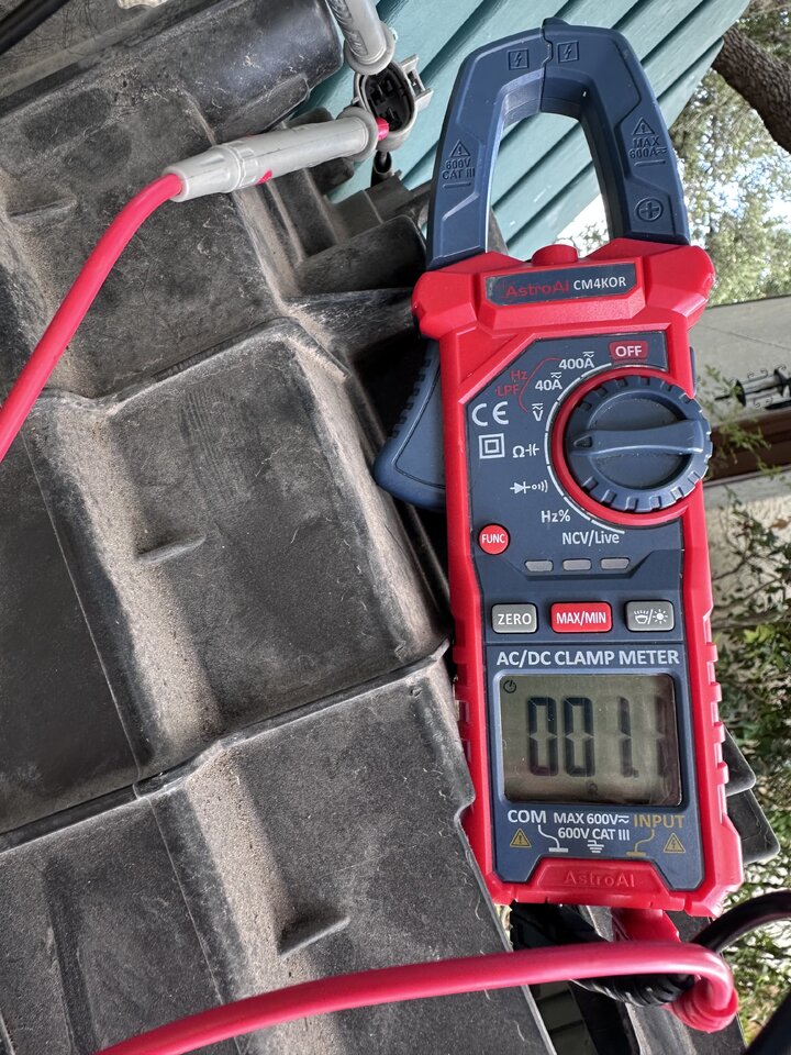

  14. LexCT200H
    Mar 8, 2025
    51
    Houston
    Thanks so much again for the guidance and correcting me @rjparker ! I tried doing some additional test, but could not do everything you suggested. It is definitely not a walk in the park even to test the bottom connector. I limited again to the top connector. This time, I disconnected the top connector, but still used backprobe to supply 12V battery. The passenger side fan still did not rotate and in multimeter I could see 12.79V. Attached are couple of pictures that shows how I tested. Please take a look. Thanks again! Resized_IMG_1091.JPG Resized-IMG_1093.JPG

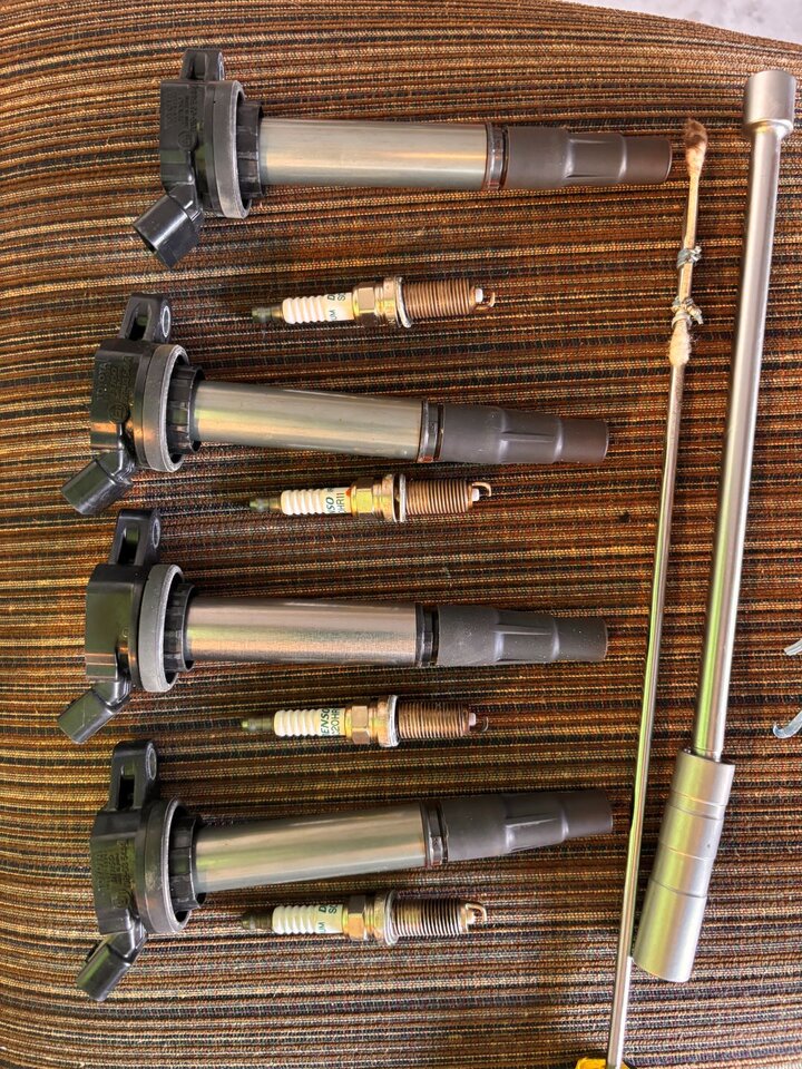

    Hi @Eddie25 : Today I tried doing what you had suggested. I replaced original fuel injectors (after cleaning using fuel injector cleaner tool), MAF, and #4 spark plug + coil. I had replaced spark plugs about couple months ago with Denso, and removed #4 amazon plug and replaced that with couple month old denso.

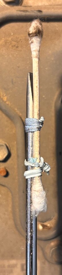

    I also did Q-tip test on all four cylinders, Q-tip came dry from all four ... there was a bit of dirt. Additionally I also did paper test on top of all four cylinders (covered all four cylinder holes with printer paper, had another person push gas while car was in ready mode). The paper was dry after the test from all four cylinders. Hence there does not seem to be any liquid in any of the cylinders.
    I could not keep the car running for longer because I noticed gas gushing out of where fuel injector and fuel rail connect. I think I did not insert the fuel injectors correctly, worse job that I did. Now I will have to remove everything and try to insert the fuel injectors correctly. I will probably do that tomorrow. Thanks again for your suggestions!

    Fan numbering looks correct. Did you try to manually spin the fan blade?

    Just to verify, when you had that connector attached to the engine harness you did measure voltage coming from the normal circuit using both meter leads at the connector?
    LexCT200H likes this.
  19. LexCT200H
    Mar 8, 2025
    51
    Houston
    Yes, I connected red from multimeter to top backprobe on the harness connector and black from multimeter to the bottom backprobe of the harness connector. The voltage was 12.79. The picture in which I labeled describes how I had connected everything, it may be difficult to see everything clearly. I tried to red-circle. I hope I did the connections correctly. I thought I had a good spare battery, but that was bad. Hence I had to use the postive wire from Lexus battery and had to ground the negative to engine body ground. Thanks again.
  20. rjparker
    rjparker Tu Humilde Sirviente
    Jun 6, 2008
    11,096
    6,961
    Texas Hill Country
    When you are testing for voltage with the connector plugged in, you do not want to supply a separate ground. The normal circuit supplies the ground.
