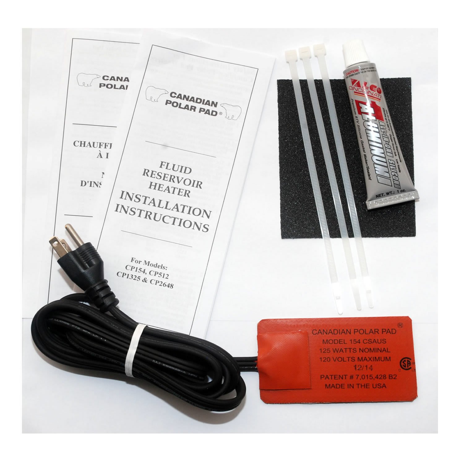

    [​IMG] This is a photo of the type of heater I want to install on the bottom of my Prius V oil pan to heat the oil and the engine due to our cold snap here in Vancouver, Canada. I'm not sure which of the plastic panels I need to remove under the engine to access the bottom of the oil pan or some other flat surface. Has anyone used/installed this type of heater? I believe Temro/Zerostart makes a similar heater. I'd appreciate any suggestions. Thanks.

    You could just try to open the oil change "panel", and see if you have enough room getting it in...

    I would take the engine panel completely off. The following is applicable to regular third gen Prius, maybe somewhat applicable for you:
    There's about 10 plastic push-in fasteners, and maybe 4 10 mm (socket size) bolts, the latter at the front. Stay organized with the plastic fasteners: there's two around the oil flap that are larger, have grey heads (vs black for the rest). When you have the fasteners off: wash the grit out of them in hot/soapy water.
    Still, I would get the Toyota Block Heater, it'll do a better job I think than an oil pan heater.
    Attachment is for reg 3rd gen Prius, parts numbers may be relevant for your v.
