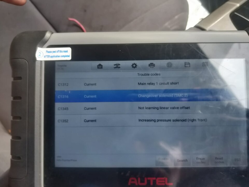

    I have these codes and I have a very hard brake
    The actuator was replaced a few months ago
    Sometimes it comes in and at any speed one of the front wheels lock up got a few warning lights on the abs light the parking brake light and a yellow light that looks like the parking brake light
    It is beeping
    Need help

    Was a NEW actuator installed or a used one? I've seen used ones installed that are bad, many times they will not do the linear valve learning, which is a required step in the replacement procedure.
    I've seen several cars with that learning code that will often have a wheel lockup as you're attempting to slow down. In my experience on test drives, it's always a front wheel. Really BAD on wet roads. Can be a scary moment in life. BIG pucker factor.
    I've never had a new one fail to work 100% properly.
    PS....I think you should probably replace your ABS relays. If one is stuck shut, the other is probably worth replacing also. That relay circuit code could also be wiring or computer, but relays are cheap and most likely.

    It was a used on from ebay
    Honestly don't know where to get a new one
    Someone also told me that I needed to change the skid ecu or something like that

    You had a used actuator install and you can't learn the linear valve offset very common you need another used actuator or a 1400 or so new one I've had to change one on one of my cars twice to get a good un it do happen . I keep a few backed up here usually

    The first thing I would do here is figure out that relay short . 1st thing on that screen . And go from they're. I understand you have a used actuator but it seems that short might be one of the two blue relays under hood should check em over pop off see if anything stuck . If you find this rectify . And try linear valve

    I will see if I can change it but which one of the relay is it

    Their are two blue relays one on top of box and one down low marked on lid as ABS on lid key . Just Google gen2 Prius under hood fuse box pics lid off see the two blue relays ? Lift up pull plastic cover off look signs of sticking the lil contacts shouldn't stick.

    Ok thanks ill change them and see what happens
