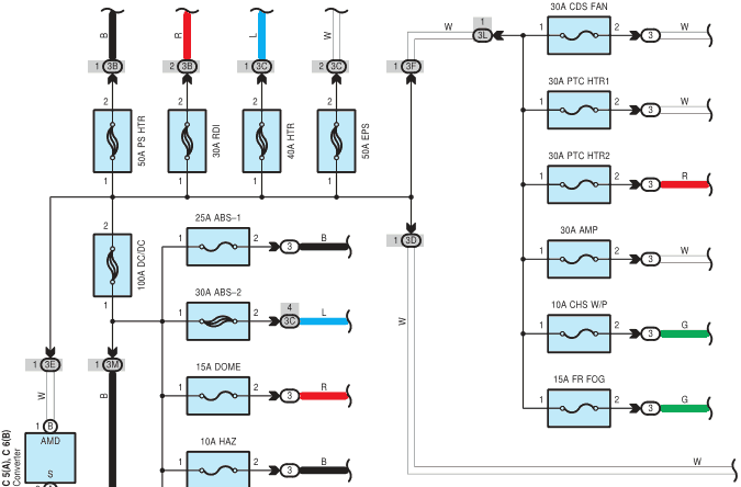

    OK, so I have 12.4 volts at the ECU-IG fuse, but not at the ECU B fuse. I also have current at the OBD fuse. Both the ECU B fuse and the OBD fuse seem to get their current straight from the 100A DC/DC fuse, so not sure why one has current but not the other.
    The two fuses I did not check because of their awkward location are these.
    1 PWR 30 Power windows
    2 DEF 40 Rear window defogger
    A gateway ECU would be cheaper and easier to replace than the inverter. Should I take that one out now?

    Take the fuses out and probe each leg socket make sure your on the B+ side of the fuse when checking.
    Stop grasping at ECU's you have alot more to check.

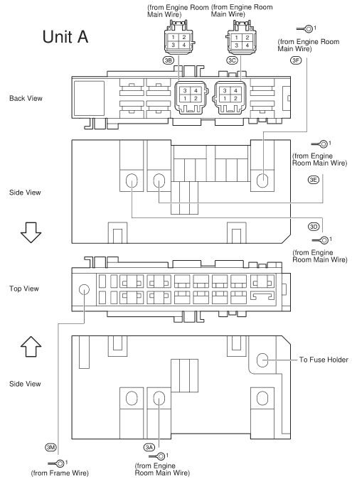

    Something occurs to me. Ed has suggested the reverse-polarity incident may have damaged the inverter (most likely the DC/DC converter, which is one part of that assembly). There is also this issue of being unable to establish communication with the car's ECUs. Converter damage by itself doesn't explain that (unless the converter was damaged in such a way that it continues to short or load down the 12 volt system).
    As there's been another recent thread where the exact needed connections were discussed, there's a way to get the converter temporarily out of the picture, and focus on whatever problems may be left in the power distribution system, and maybe get back to a point where the ECUs can talk.
    You can isolate by unbolting the fat white wire at position 3E of unit A in the underhood fusebox:
    With that wire unbolted (and wrapped in something insulated so it doesn't go flopping against random metal car bits), you have the converter, which may or may not be blown, removed from the 12 volt picture. Everything else is still connected to your 12 volt battery, and with a good charged battery there, you should have 12 volts everywhere 12 volts should be, or be able to track down what is open if you don't.
    With 12 volts everywhere 12 volts should be, you ought to be able to communicate with the ECUs. Or with some of the ECUs and not with others, and you can also start narrowing that down. The "multiplex communication" section in the manual gives an overview of the different communication networks in the car and which ECUs are on which ones.
