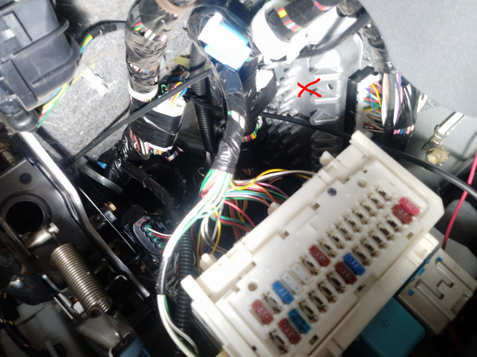

    OK, for the photos:
    IG1 Relay out
    Again:
    Temporary 100A DC/DC fuse solution:
    Fuse box and ground location. X marks the spot I put the black probe at.
    And again:
    The reading:
    I have tried to take a photo of exactly where I have the probes documenting an actual reading, but because of the awkward placement of the fuse box, I was unable to.

    This what I am looking at. Could it be a blown body ECU?
    Edit: I can't seem to upload a full resolution version of this.

    Squishing some of those diagram bits together just for ease of reading:
    I don't think that I suspect the Body ECU quite yet, just because I see zero ways for it to produce the observations you're reporting. If you have removed the IG1 relay plus fuses 2, 3, 4, 5, 6, 7, and 18, there is nothing left to be supplying that particular bus with power; there is no trace of it that continues down the diagram to the body ECU.
    There is the slight mystery of 1J pin 8 (lower left). It is odd that they have an unfused IG1 tap coming out to the connector, and my guess is if you examine connector 1J you will find no wire at position 8. Probably they brought that out as a diagnostic test point. (It would give you a place you could tap in for ignition-switched power, by buying the right repair terminal and adding it in position 8, but you'd have to bring your own fuseholder and fuse. You might prefer adding a fuse in the unused slot that seems to come out at 1N(11).
    If there were something connected at 1J(8), it would be able to supply voltage you would see on that bus, even with the relay and all those fuses out. But I am guessing there is nothing connected there.
    I struggle a little to keep my bearings in your photos though. When I look at this one, I feel like I'm seeing the IG1 relay removed, but fuses 3, 4, 5, 7, and 18 in place, which I hadn't expected:
    Then when I look at this one, it is disorienting; there seems to be a relay where IG1 would go, but it looks more like the flasher. Was this one taken with the selfie camera, and mirrored?
    I'm going out on a limb and saying yes, because I see what look like 12 amp fuses, and I didn't know they made that size. ;)
    Anyway, in neither picture does it look like the removed fuses are the ones I expected. Am I all turned around?

    I suspect I am an idiot. You're always the last one to find out. I will now go and put the fuses in the right order and report back on what happened.

    Well, today I have learned that I am in fact an idiot and that the Prius, and probably other cars too, work much better when the fuses are in the right places in the fuse box. Who would have thought?
    I have OBD, MFD and dashboard lights! On the downside, I do have the red triangle and the MFD saying the transmission lock is on.

    Sadly, it took me a laptop to figure out that I forgot to connect a wire to the HV ECU. Plugged it in, the engine runs, everything seems to be OK.
    In the end, the only thing the reverse polarity caused is a blown DC/DC fuse. Everything else was down to my expert vehicle repair abilities. I did learn a lot in the process and fortunately didn't spend a while lot of money in the process. Incidentally, does anybody in England need a an Engine ECU?
