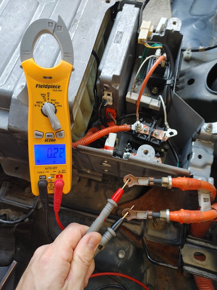

    checked frame wire continuity and for any obvious shorts to ground, none found. kind of waiting on a week's worth of rain to pass so I can get under the hood and pop the lid off inverter to finish probing...
    disconnected and tested the circuit breaker no. 1 bolted to side of inverter and it tested out at 819K ohms... is that good or bad?

    I removed all bus bars and sense wire tabs, and cleaned them all with green scotch brite, wire brushes, and some vinegar/salt/baking soda, 99% isopropyl alcohol and re-torqued all stud connections to spec to eliminate any odd resistances, corrosion, etc. Tested all wires from tab to plug tip and all pass continuity / resistance tests. etc. I am confident my HV pack 's core is fine, but the junction box components are still a possible culprit.
    you can listen to the relays attempting to power up and ready the car here:
    https://youtube.com/shorts/rqCytwGIe1w
    The HV pack measures 213VDC pack side. Min/maxed it on the output side of the contactors and only got 1.9VDC MAX on the output side, probed between output +/- frame wire connection studs on the output sides of the contactors.

    The other day when testing my System Main Relays (contactors) that connect the battery to the inverter, I was getting the full 213+ VDC out the inverter side of the contactors while the frame wires were disconnected, but as soon as I reconnected the frame wires to the inverter side of the contactors and attempting to start up, immediately went back to faulting out.
    I think today after work, if the weather permits, I will disconnect the frame wires from the back side of the inverter and disconnect the battery ECU and inject 12VDC to activate the contactors and test the output voltage at the plug tips of the frame wires where they normally plug into the inverter to see if:
    A.) I get the full 213+ VDC to the inverter plug tips
    B.) there are any egregious frame wire shorts or similar I have not found yet
    If that tests out okay, my next course of action will be to pop the lid off the inverter and examine some of the internal connections within, but my gut feeling tells me I am headed for an inverter replacement.

    ( here is my resistor test btw: battery ECU and contactor plugs are all disconnected while I am shorting pins and injecting 12VDC to activate the smaller main relay that activates the 2 main contactors while the frame wires remain disconnected from the inverter in the engine bay)
    when I disconnect the main plugs from the rear of the inverter and probe the inverter terminals themselves, they appear shorted (0.1 or 0.2 ohms I believe).
    is that normal?
    can anyone with a known good Gen 2 inverter in the car perform the same test for me and let me know?
    If I can definitively say which component inside my inverter converter assembly failed, I am not opposed to doing a component level repair. I just want to be able to verify first. I see components of the inverter/converter assembly for sale on eBay for cheap and most of the 2G assemblies probably should have their thermal grease replaced anyways to help prevent overheating.
    I tested the resistance of my frame wires and both show 0.05 - 0.10 ohms from inverter plug tip to battery terminal tip, so that's good.

    I'm not sure if this is the image that goes with your description. I see your probes across the frame wire center cores back at the battery. Are the front ends connected to the inverter at that moment, or no?
    If they're not, you've got a frame wire short. If they are, the reading could be normal, considering you've got a puny multimeter trying to "measure" the capacitors inside the inverter.
    That safety interlock circuit runs from the HV control ECU (not the battery ECU), through cover interlock pins in the inverter, back to the rear of the car, through the service plug interlock pins, and to body ground.
    it also gives you the code P0A0D if it is open anywhere. If you do not have that code, I don't see this circuit as a concern.

    yes, in that picture, the frame wires ARE CONNECTED into the inverter up front as they would normally be during standard operation
    the only test I have not explicitly carried out so far is the megger test but I really don't think I am dealing with a significant short to ground situation based on all evidence presented so far
