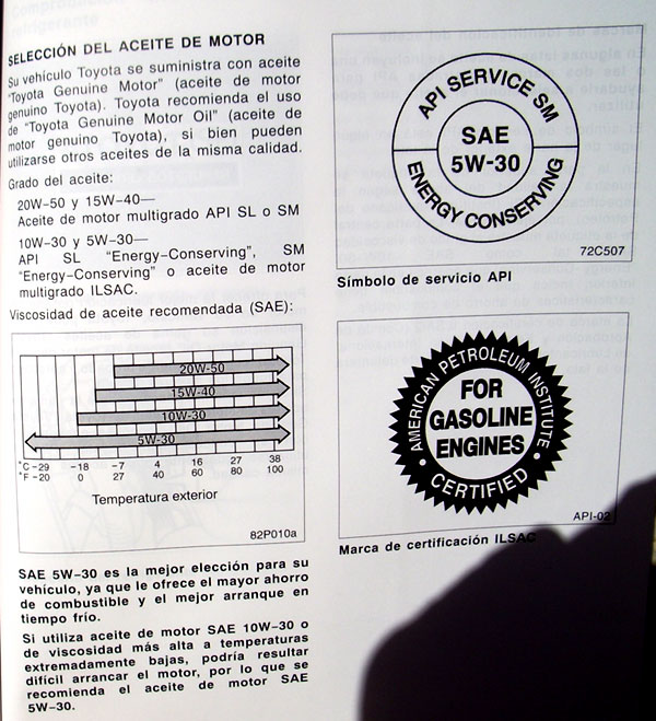

    Just for reference, I don't have 0W20 (or any other number) on my oil cap. But here's a pic of my manual (in Dutch, but the graph should still make sense ;) )
    Below it is a pic I found on Prius chat somewhere, presumably from a an older Prius II???

    And... thats EXACTLY my point.(y)
