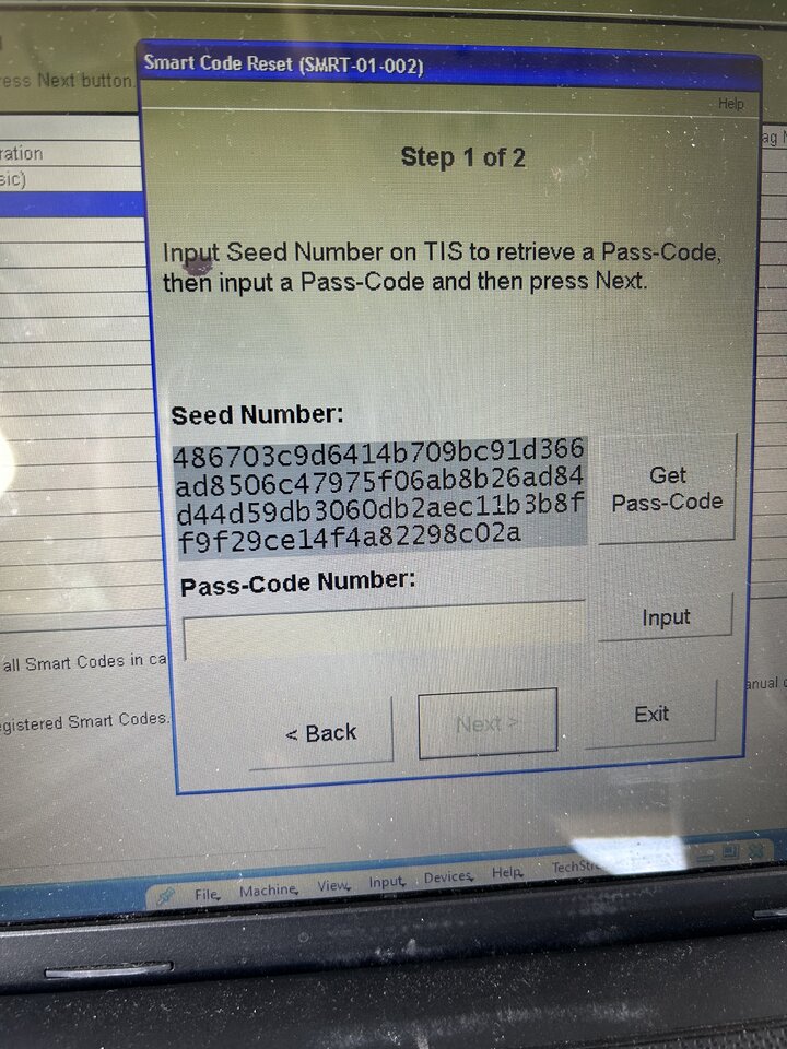

    Prius 2013 gen 3 around 150k miles . If someone could guide me or help me. I’ve been on a non stop grind trying to figure out what the problem is in the car is now chatGBT is telling me it’s the ecu I swapped it out and chatGBT said it was correct that was the problem now I just need to connect it to the new key fob but before I do that I need to do a smart code reset because my power management control doesn’t recognize it since I swapped it . If someone has a website or something trustworthy I can use that’d be great!

    From the manual on the error with the code C2300: Open or short in the integration relay or shift control actuator assembly (parking lock motor or rotation angle sensor), or internal malfunction of the shift control actuator assembly (parking lock motor or rotation angle sensor).
    Trouble Area:
    • Transmission control ECU assembly
    • Auxiliary battery
    • Shift control actuator assembly
    • Hybrid vehicle transaxle assembly
    • Wire harness or connector
    Where is it indicated to change the Power Management Control ECU?
