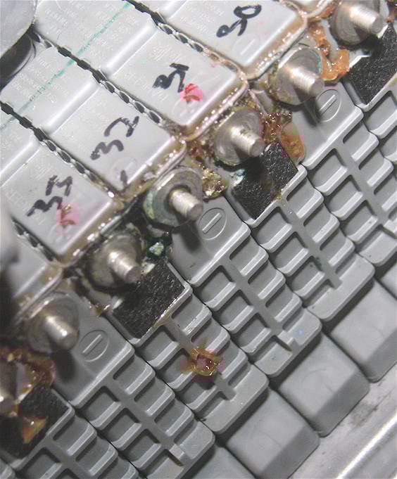

    The temperature probe orientation is the same as the original NHW11 modules. Here is how I tell the difference between NHW11 and NHW20 modules:
    Here you can see the temperature probe 'fingers' are rotated 90 degrees in the lower, newer module. Also the terminal end plastic is much thicker and stronger. The 'silver' is some sort of mold release and non-conductive.
    The biggest advantage are a doubling of cell-to-cell connections that cut the module resistance in half. This significantly reduces heat concentrations that weaken the terminal seals.
    This last photo shows the 'goop' that was added to handle terminal seal failure. Module 33 shows the tell-tale, black "O" ring failure associated with failed modules. This allows the KOH electrolyte to leak out and eat some of the buss bar, the green speck. The black pad is to absorb the electrolyte so a short to the case won't happen 'right away.'
    When I choose to upgrade my traction battery, it was working perfectly fine but I knew my used 2003 Prius had been driven hard in Texas. Changing the transaxle oil at 53,000 miles, it was opaque and smelled like paraffin. But I wanted NHW20 modules, not the NHW11 ones:

    Once again, I want to thank you for your excellent photo. Seeing the temperature probe finger orientation strongly suggests it uses the old-style modules. Without taking off the cover, I can't tell if it has the 'goop' treatment and without a photo of the module ends, confirm the thicker or thinner terminal seals. So Toyota could have rotated the fingers again in the ZVW30 modules, I don't have an example, yet.
