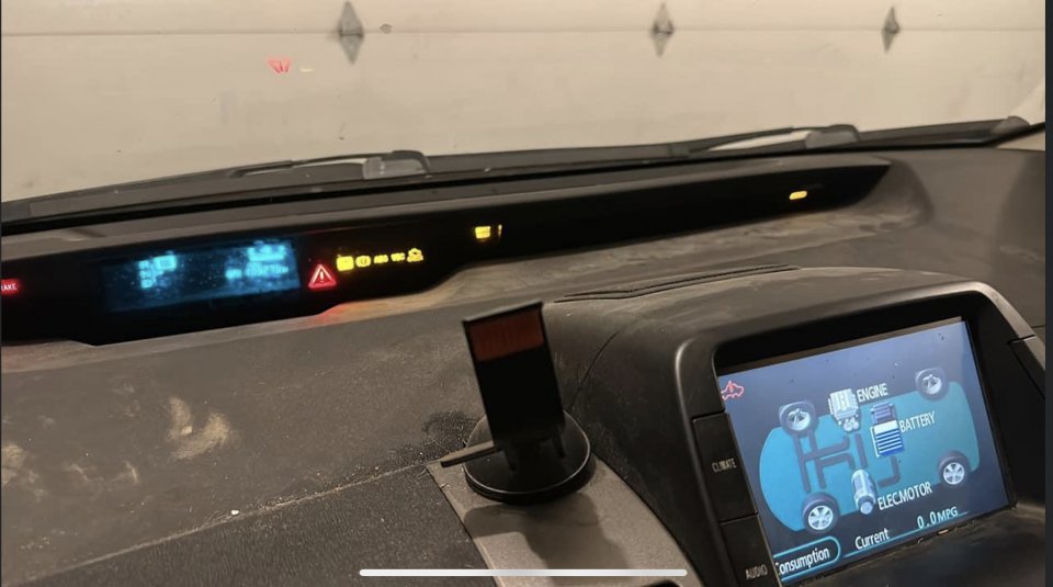

    Could use a little help please.
    I had one cell fail on my 07 Prius so I replaced it with a used oem (7.8v) cell. Cleaned everything and put back together. Re-installed the orange safety plug. Vehicle will power up but now every light in on the dash and engine will not start up. Is there a reset I need to preform or? Any help would be very appreciated.

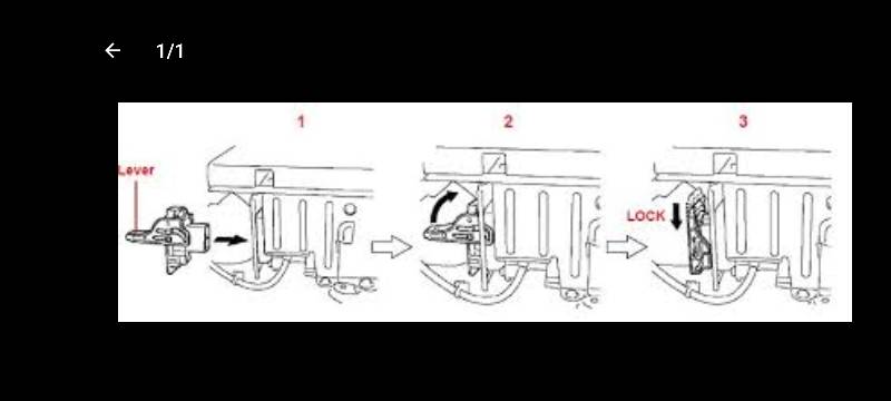

    When you reinstalled the safety plug, did you slide the handle down until it clicked? It's 3 steps - push the plug in, swing the handle in, slide it down.

    Definitely verify Post 2 was done correctly.
    Did you disconnect the 12v battery? Your photo looks an awful lot like what happens the first time you press the power button after reconnecting the 12v. It seems like every single warning light illuminates, but then press it one more time (also with foot on brake) and all the lights clear and the car will do it's normal thing and go to READY.
    You are showing:
    BRAKE
    Master Warning
    Traction Control Warning
    Brake Warning
    ABS
    VSC
    Check Engine
    Maintenance Warning
    Are any of these on due to a good reason? Like BRAKE is on due to parking brake engaged)
    Were any of these on prior to the work you performed? (like maintenance warning, etc)
