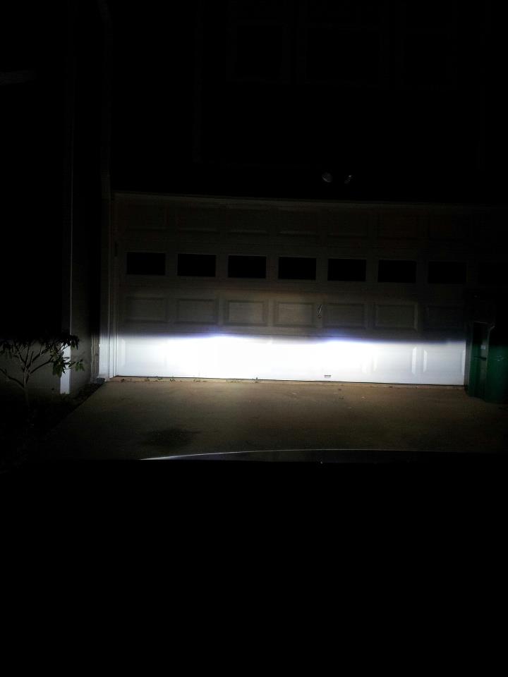

    W/out fogs

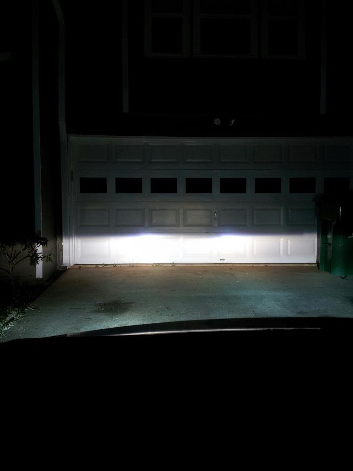

    W/ Fogs

    I'll try to take a better picture this weekend that gets the broad spectrum and one from the outside, but as you can see, the headlights are higher than the fogs.

    wow the fogs have a clean cut off! Are those the OEM fogs? Please say yes, because my dad ordered the OEM ones. I was dearly worried about a spray of stray light going all over the place from the reflector housing in the fogs.

    These are the OEM lens with the HID kit.
