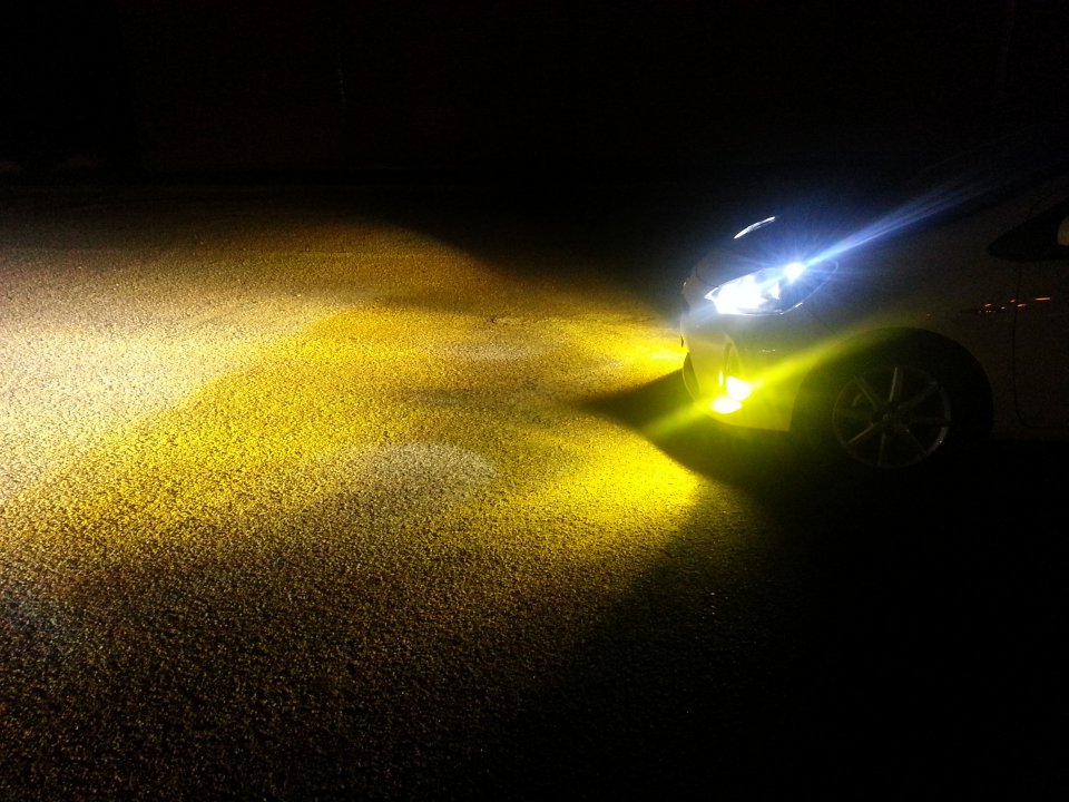

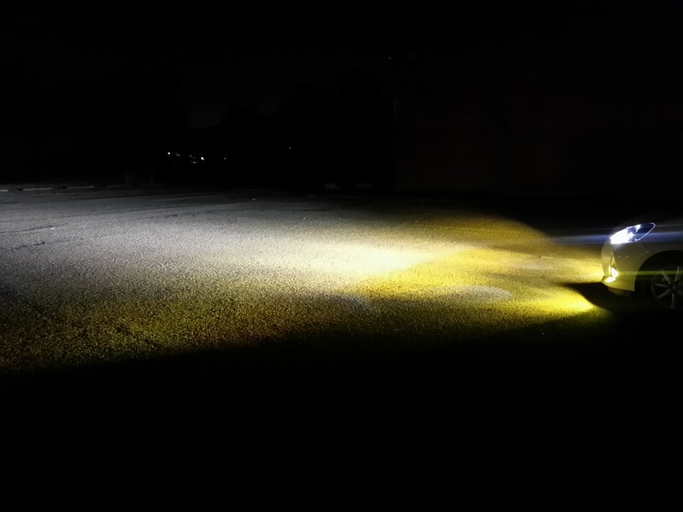

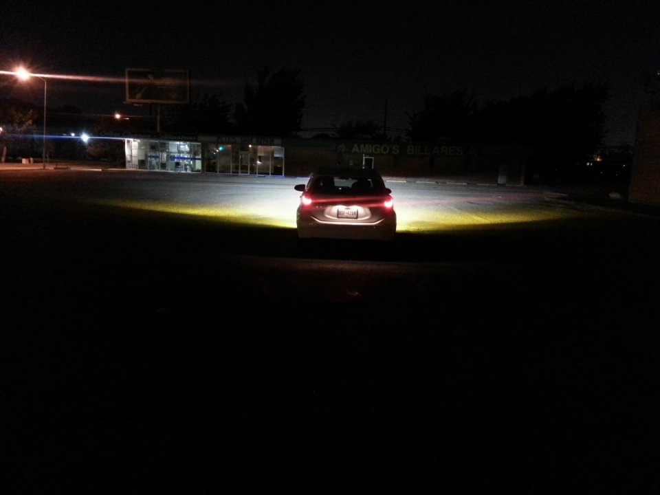

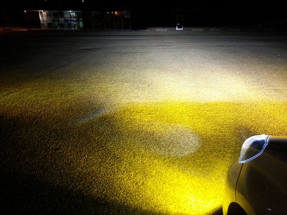

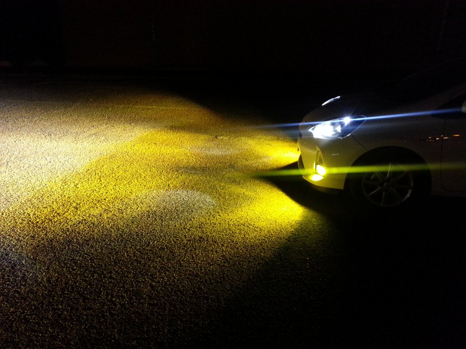

    Got the H11 HID kit installed in the fogs, I have yellow vinyl covering the fogs. I'll try to get a video of them turning on, they are initially green when they are warming up. But there is a lot more yellow on the ground. I'll probably end up trying to retrofit the halogen projectors in there for better lighting and aiming. Sorry for the quality of pictures. Had to use a phone for pics.

    Lookin good Mo!
    To sum up your fog light set up, they are OEM assemblies, 4300k 55W H11 HIDs, with yellow vinyl tinting? The output is quite impressive compared to the stock halogens I have (which I can't see from my seat at all).
