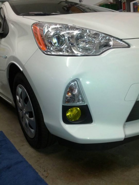

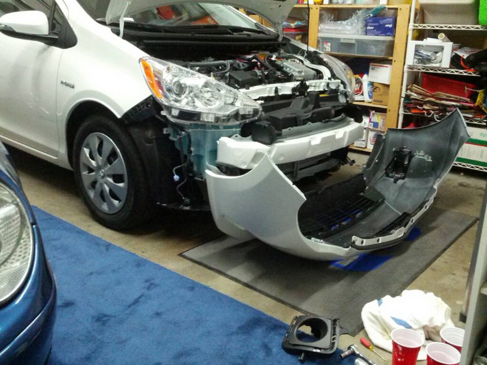

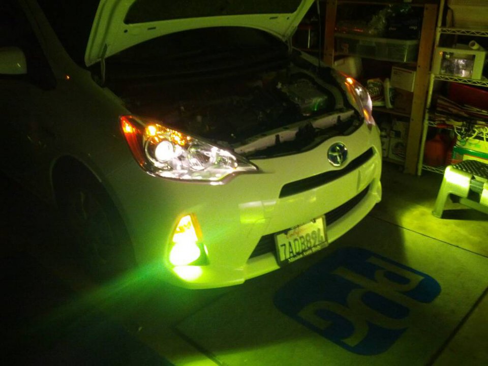

    uploadfromtaptalk1373862986241.jpg uploadfromtaptalk1373863007712.jpg uploadfromtaptalk1373863026068.jpg
    There it is! I'll try to get better close ups if you guys care for them. I can't get any beam pattern shots right now, but I'll try tomorrow night maybe. BTW, I have a C3 and added the C4 stalk. Can I still run the fogs independently of the low beams? Doesn't seem like it's possible.
    You might also notice my low beams are back to halogens :(. Just swapped them over from the fogs, which are only 19W and definitely not even comparable to the HIDs that were in them before.

    Just as an update, I've been running this set up with little issues. Only issue is the "splotchiness" from the air bubble forming behind the lens under heat. Otherwise, nothing is melting or burning and output/color is beautiful.
