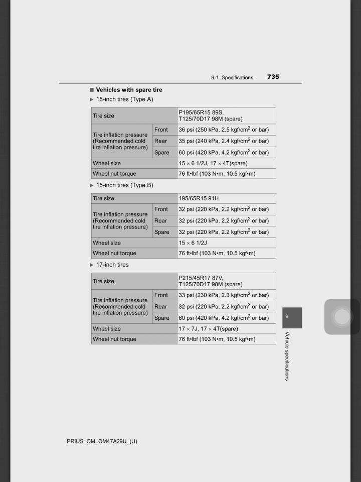

    mmmm... so from another thread, it seems that Toyota wants you to inflate the 15" at the hypermiling pressure of 36" only if you have a tire 89S (defined as "Type A"), not if your tire is 91H. And we know the effect of extra pressure on mileage.
    So i guess if they delivered some Two ECO with tires marked 91H, they are not fulfilling some kind of promise about the mileage, due to the lower pressure on delivery.
    Looking at the spreadsheet, for the time beeing the Two Eco seems to be fitted with the Ecopia 422 Plus: can some owner double check the speed/load index on the wall? And it would be interesting to know the same for the Nanoenergy A29-
    PS: According to Tire Rack, the Ecopia 422 Plus 195/65/R15 only exists in 91H version, so actually the Two ECo should'nt be allowed to run the 36 psi pressure...

    Thanks for clarifying, i've missed it. Now it would be interesting to know if the Non-Touring Non-Eco have the same tires (i mean the same speed/load parameter) of the Two ECO.
    Thanks for this, for us europeans. Bad news, the EP150 is an old tire class B on RR and B for wet. The same Bridgestone have the EP001S A for RR and A for wet, difficult to understand Toyota choice. In terms of FE, the difference btw an A class and a B class could be substantial. We have quite a few Prius and Auris HSD on the forum , using aftermarket EP001S and they go like a charm.

    maxwell, what chart is that showing type b, that they've gone to 32psi all around in the 15", including the spare, in your post #21?

    That would indicate a near balanced axle ratio when full of fuel and with two 150lb passengers in the front seats and one 150lb passenger in a back seat that give the greatest load to a wheel. These are Fed code requirements.
    Higher psi for the 89S tires because they have lower load to inflation pressure values than the 91H. 1279@max vs 1356@max. Pressure to load is close to linear for these tires. Comparing Bridgestone. Variation in curb weights between models not that significant compared GVWR or the load given above.
    Type B gets full sized spare?

    Right, so according to Toyota you have on a Prius FOUR a (non standard supply Toyo) Type A (89S) as indicated by Bridgestone press release.
    If we guess that the 36psi 89S is more fuel efficient than the 91H run at 32psi, tires cannot be the reason of such a large gap in FE btw 2ECO and 2,3,4.....
    Then, look for software and engine tuning (or whatever BIG) for the ECO miracle, beeing the remaining known differences not really a way to justify the gap.
    According to Bridgestone , all the non-touring Prius US should have the 15" 89S at 36 psi.
    PS: As a side note, just some new NEDC and info for Prius IV EU came up. We don't have any ECO nor any trim using the Li-Ion, only Ni-Mh.
    The NEDC values are given for the 15" and 17" separateley tested:
    15" city/HWY/combined 2,9/3/3,1 L/100km
    17" city/HWY/combined 3,3/3,3/3,3 L/100km
    So, a 6,5% decrease in FE is measured for the 17".
    Absolute values are absolute b***shit , but the difference, for city and medium speed, should be reliable. I do repeat, hypermilers better stay away from Tourings.....

    For 15" USA gets the type A Bridgestone 422 89S or Toyo NEA29 89S. Europe and Japan are getting the type B Ecopia EP150 91x or ? with a lower psi. That's what I see anyway. What's supposed to be on the 2Eco again?

    but on page one, the door jamb pic shows 36/35? are we talking usa only?

    2 Eco placard picture shows 39 psi front 36 psi rear. This different from the table. Could the 2 Eco also have the 640 vs. the 540 treadware rated 422's? Are there variants of the Toyo A29?

    No other option than the EP150 91H for the 15" in Eu, but the car is not yet for sale, so we don't know if it ends up with some other tire.
    From the Bridgestone Press Release, is not quite clear if Bridgestone got some exclusive supply.....
    That's the point of confusion. Toyota Prius owner manual does'nt mention the 39 psi option.

    The placard on the door jam is the law here. Who knows when the manual was created.
    Higher tire psi plus higher treadware/lower rolling resistance tire variant plus -70lbs. equals how much MPG gain?
