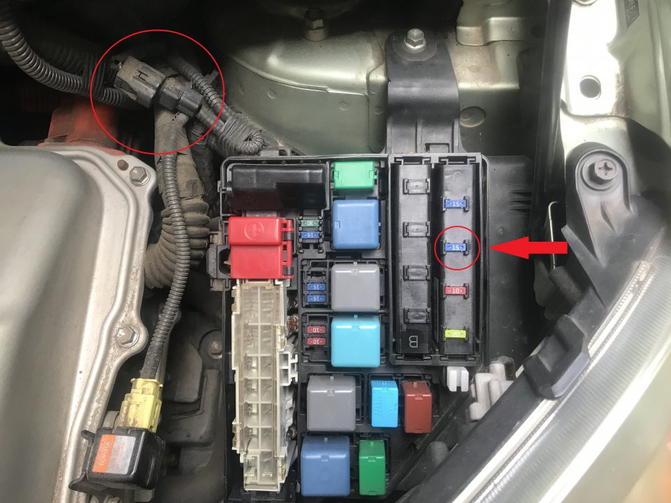

    You found no AM2 fuse as pictured below?

    The layout of my fuse box looks slightly different but the one on the right second from the top (#9) is labeled IGN, which is probably the same as AM2 in the US version. It was not blown, none of them were. The fusible link was also still connected from top to bottom on both metal strips.
