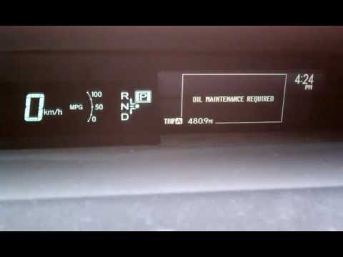

    Not my pic but this is what was displayed.
    New used car, so great advice to check, a lot! Got dirty quick after change but level is steady after a few hundered. Im checking 2ce a day until I'm comfortable. That car is my main source of income. (I have a courier co.)
  13. orenji
    orenji Senior Member
    Aug 17, 2013
    5,887
    3,490
    That is maintenance message. This will come on every 5k miles. You should change the oil each time, don't go 10k miles between changes.
