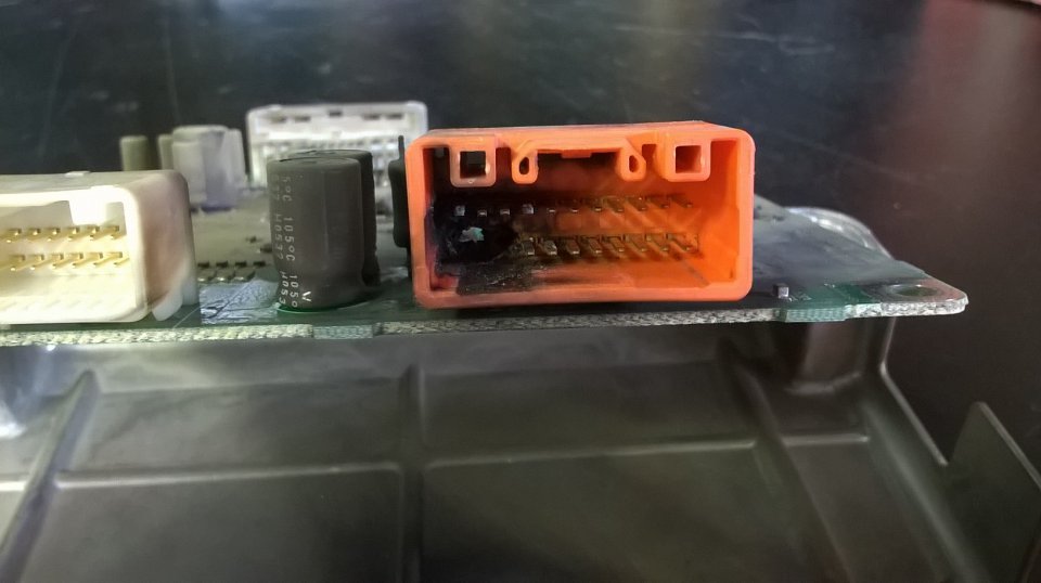

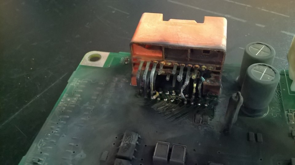

    (d) regarding the battery: if you are mechanically (and electrically) adept and have a full day,
    I would suggest pulling the HV battery out, doing some disassembly
    and cleaning all the contacts that charge the battery, plus the battery terminals themselves (all 76 of them).
    After 20+ years, the bus bars are likely corroded and could use a scrub/polish to get rid of green gunk.
    The multi-pin orange connector that plugs into the battery computer (in the HV battery itself) from the bundle of thin wires
    (which sense/charge each cell of the HV pack) is prone to corrosion (sometimes charring; and, rarely, fires) so a good
    cleaning once every 10 years is in order with tv-tuner contact cleaner (if you can still find some).
    The HV battery system definitely does NOT like to sit unused in a high-humidity environment.

    Chap, thank you for linking to the "Prius battery fires" thread for the charring HV battery connector issue.
    Trombone, it's a serious enough issue that you may want to have Toyota (or your trusted hybrid mechanic)
    do an inspection just of that part (and pay the coin, as required), particularly if your battery pack is more than 10 years old.
    There are no warning signs. The corrosion, helped along by humidity, is like rust. Rust never sleeps.
    Hope is not a plan.
