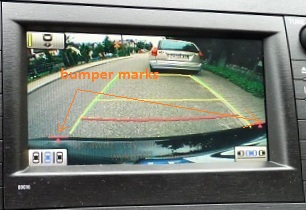

    The UPPER part of the rear bumper should be visible.
    The edge of the bumper also should match two markers on the screen below the red line. I have older model than yours but I think in general the screen is alike.
    screen.jpg .

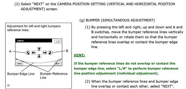

    In some unusual cases when the picture doesn't correspond to the basic pattern it is always possible to adjust geometry of the camera in accessory or service mode.

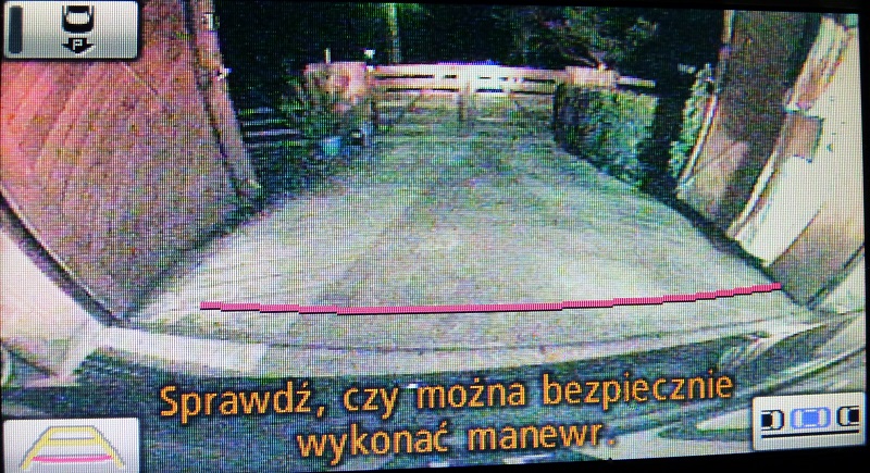

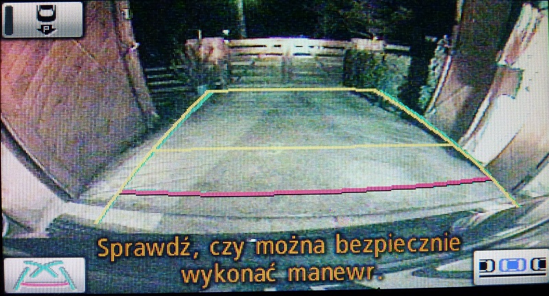

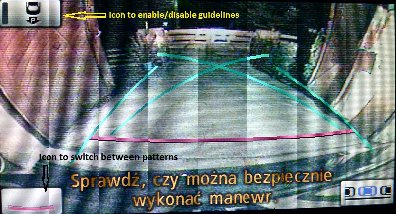

    On my screen in upper left corner is the icon which enables/disables guidelines in three different patterns.
